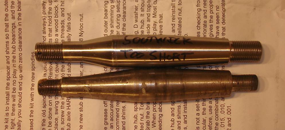

I don't <span style="text-decoration: underline">know </span>but my guess is that "uncle jack" had a big run of them made (probably by Southwick) and that everyone is still selling parts from that run. With modern CNC machining techniques, the setup frequently costs hundreds or even thousands of times as much as each part, so it makes sense to make each run as large as possible to keep the overall per unit cost down.
Again I'm guessing that the pricing differences can be explained by normal markup policies.
Here's a photo comparison that shows the difference more clearly:
