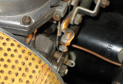

does anyone have a pic of how the cable routes through the carb???

The cable with housing go thru firewall to cable stop on carb side of the fast idle cam on front carb. Housing stops there and cable goes up thru hole in nort on top front of the carb housing.
