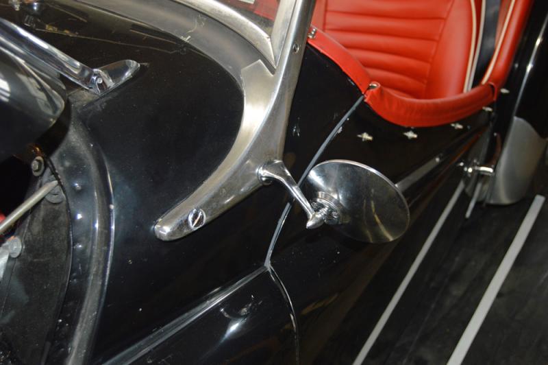

macilona
Member
They are the harley davidson 3” round with 4” stem. Order the hd right side to go on the car left side. They screw right in…no issues. I found them on ebay.

I.ve heard it's a real ordeal to remove the existing stanchion screw?
Just got some for my 3B the threads were wrong but easily fixed. Cheap and quite cute.
Mad dog
Where did you buy the mirrors? The stanchion screw hole is 5/16". Most mirrors now are 8mm. How did you fix the thread issue?

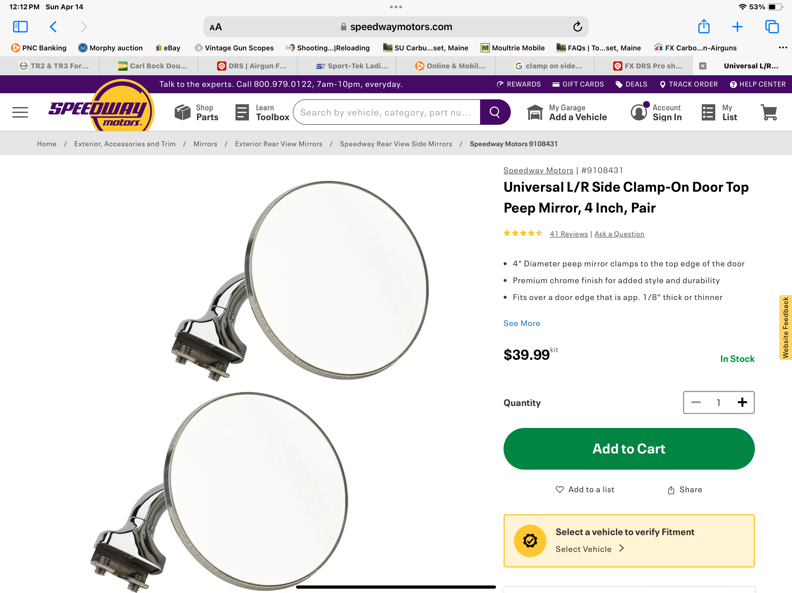

Leatherman
Member
I used these. They are nice as you can adjust them up or down as you like. But they must be removed if you use side screens.
