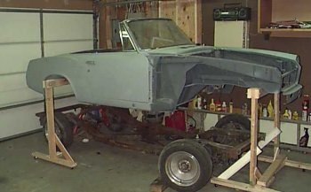

Similar to oldtimer I built a wooden rack with wheels to hold the body tub with enough room underneath to roll the frame. I used an engine lift to remove the body tub and offer it up to the rack.

PeterK
Wood works too. I built one similar to this one. It worked great.
