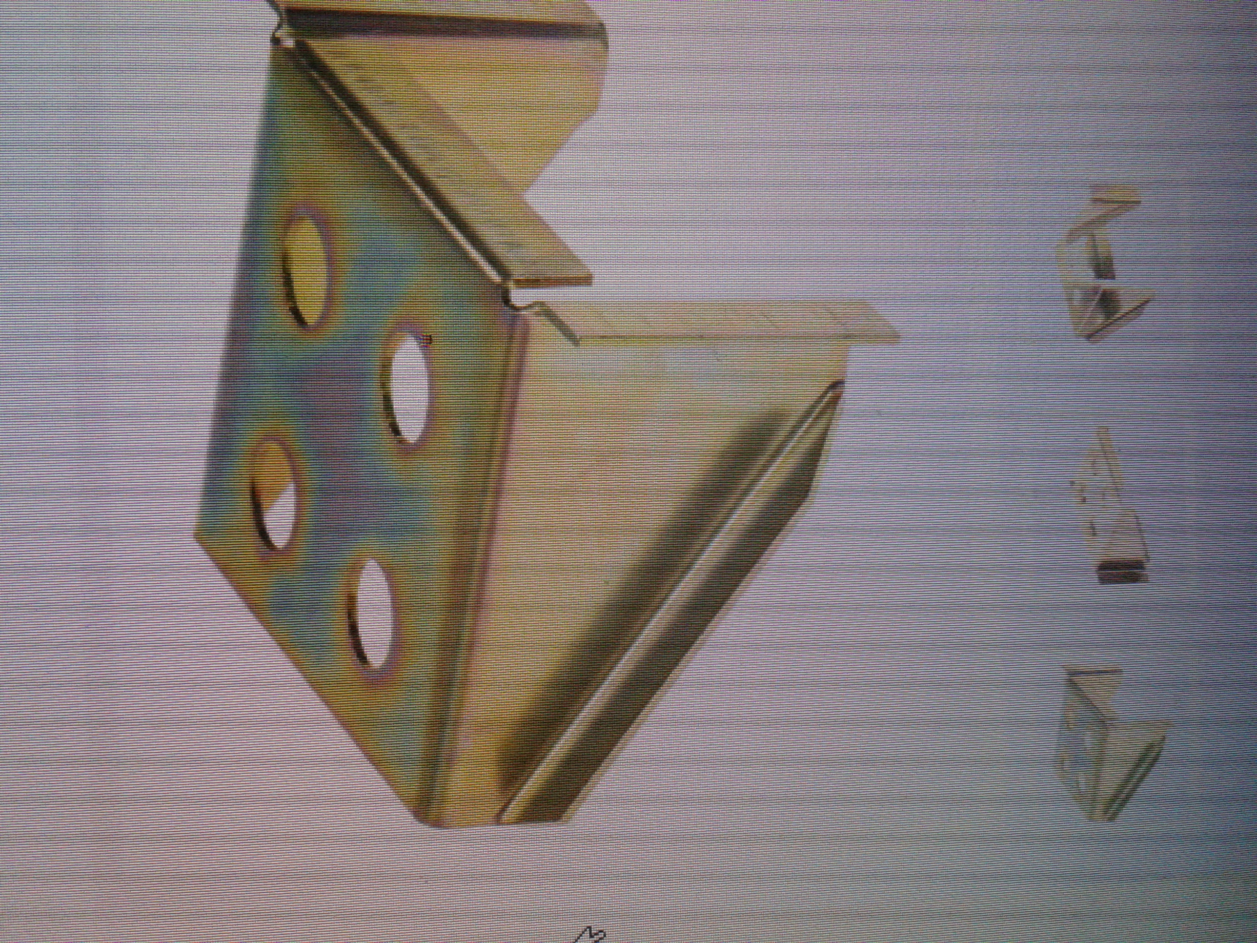

This might help. The brackets are welded at the inner rocker panel, and I think that's all.
This is a TR4A picture, but I believe the TR6 is the same.

Thanks Sarasto that's what I needed. Yes TR4 thru TR6 are the same floor boards. I think early TR4 had a hole for the e-brake but the overall shape is the same. It took me a while to get back to you that wanted pics. I looked at our future forecast and it's not pretty here in NE Ohio. Lots of 40s and 50s so I went on a 3 day sandblasting spree. My goal is to get the body on the frame with the engine compartment painted before winter. Primed the underbody with PPGs CRE yesterday. I'll clean up some pits and holes I welded up in the trunk floor this weekend then after this rocker situation is cleaned up then I'll shoot it with some color.

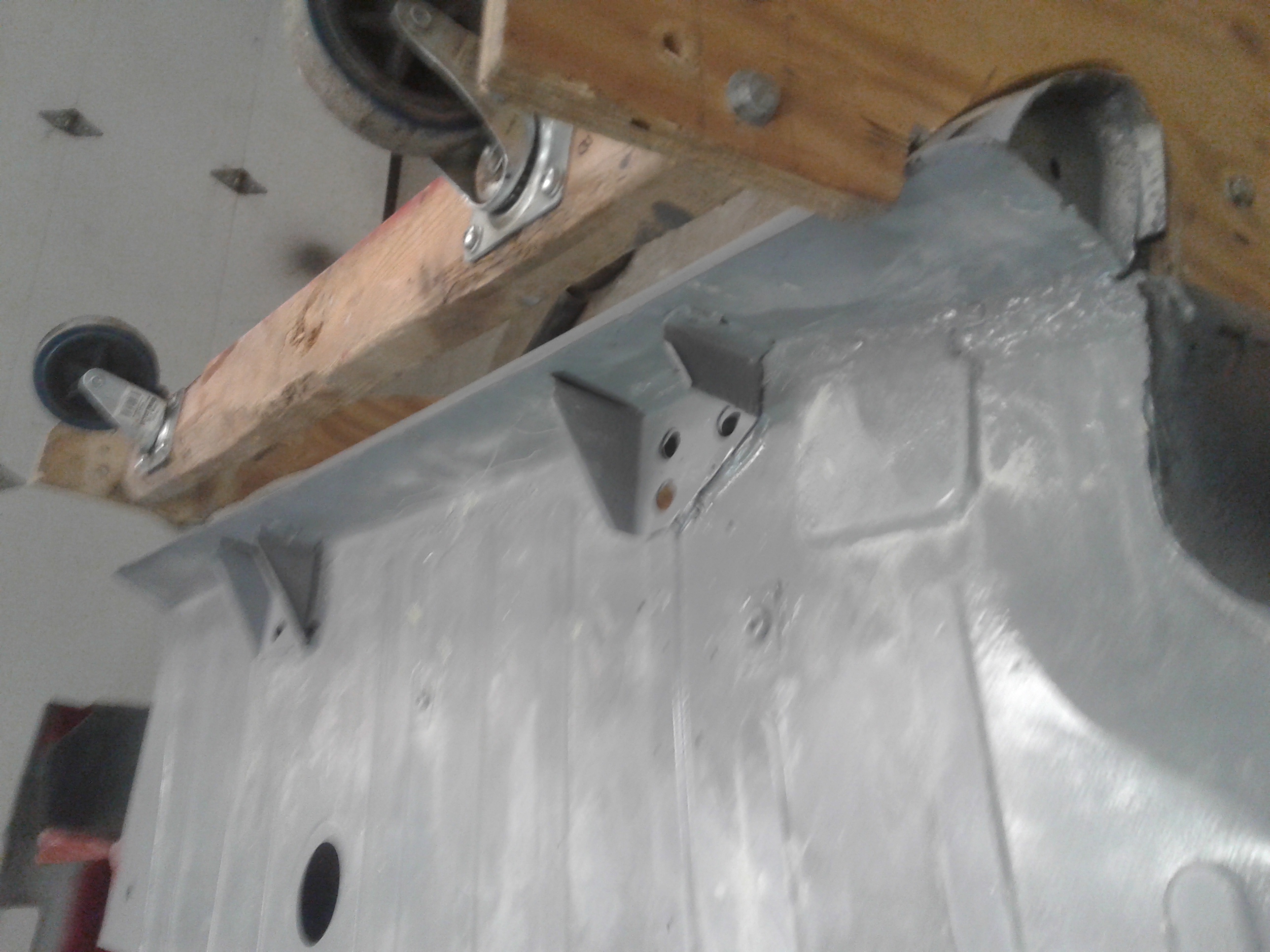

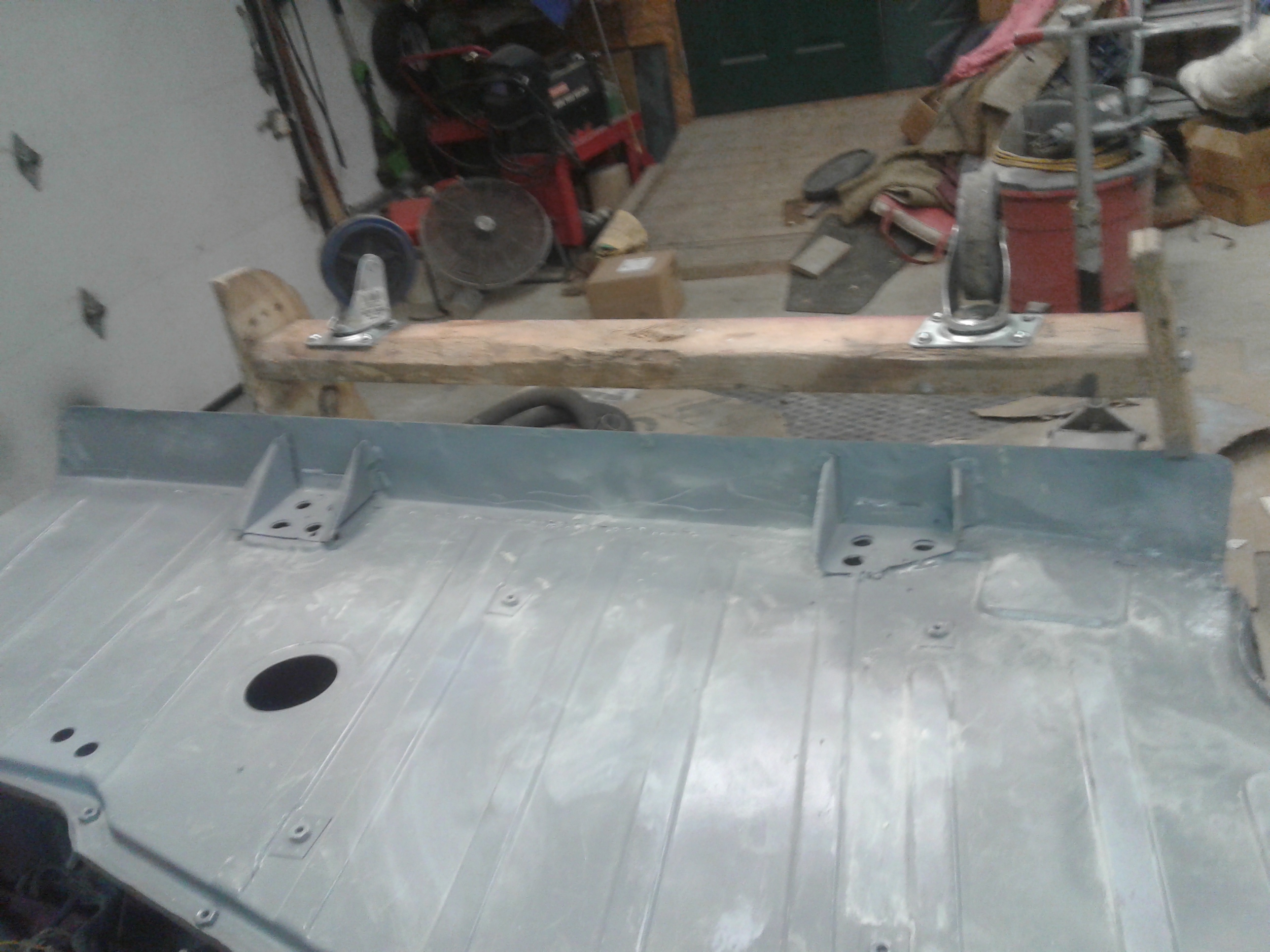

Here are some pics of the other side that I did not start on. Wanted to do the harder side first. Anyway this side is much closer where the passenger side was about 1/4 to 5/16" away from the rocker. If I put the bracket against he floor it's too far away from the inner rocker. If I push it to the rocker it's too far from the floor. I examined the rockers for a while and noticed they were a little wavy so I was able to pulled them into a better shape. Now when I place the bracket to the floor it's much more acceptable of a space. I was able to straighten the brackets out and had to bend the farther edges down to touch the rockers. I'll have to run a small bead instead of plug welds. I'll send some more pics as I go along.

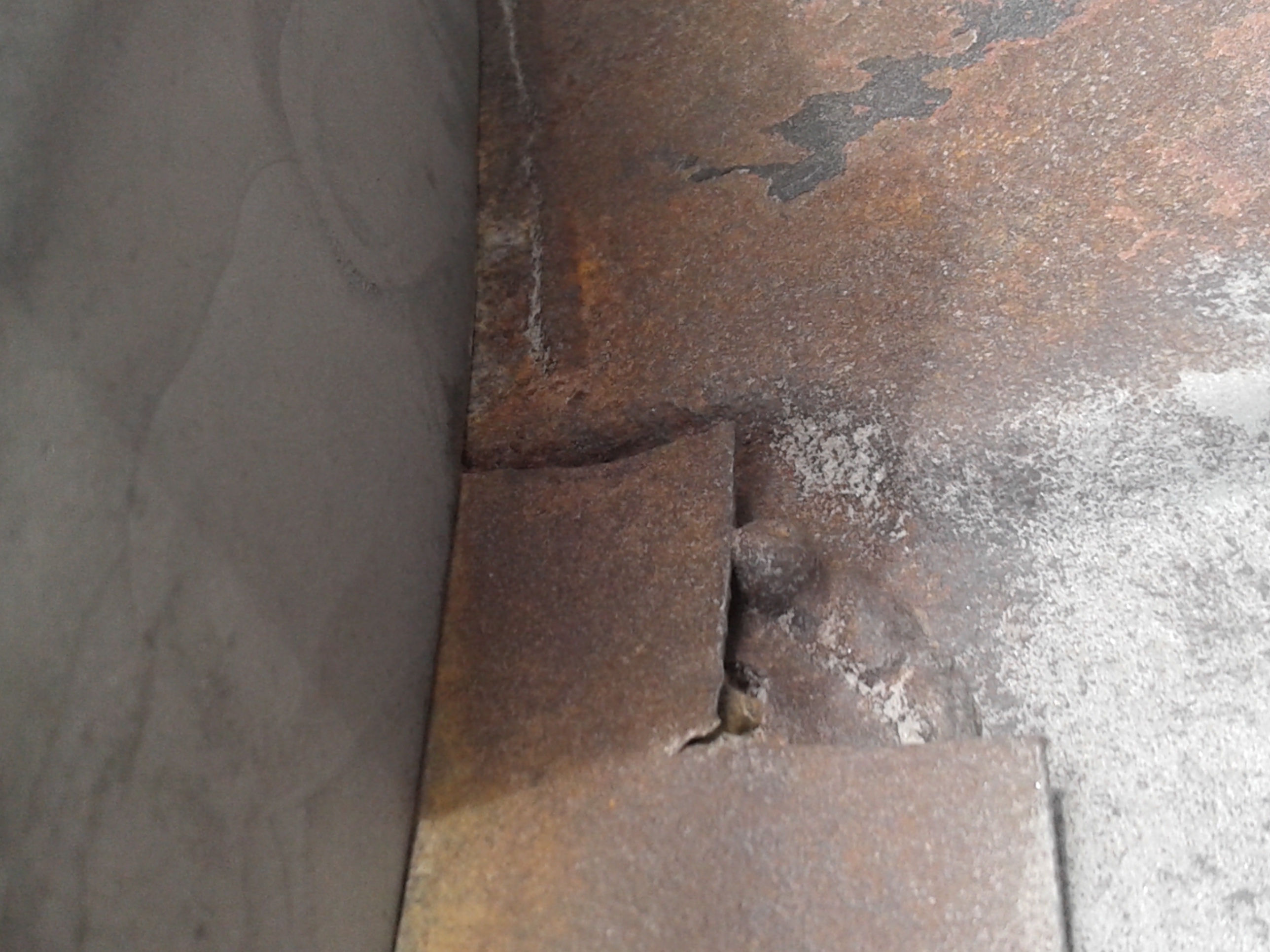

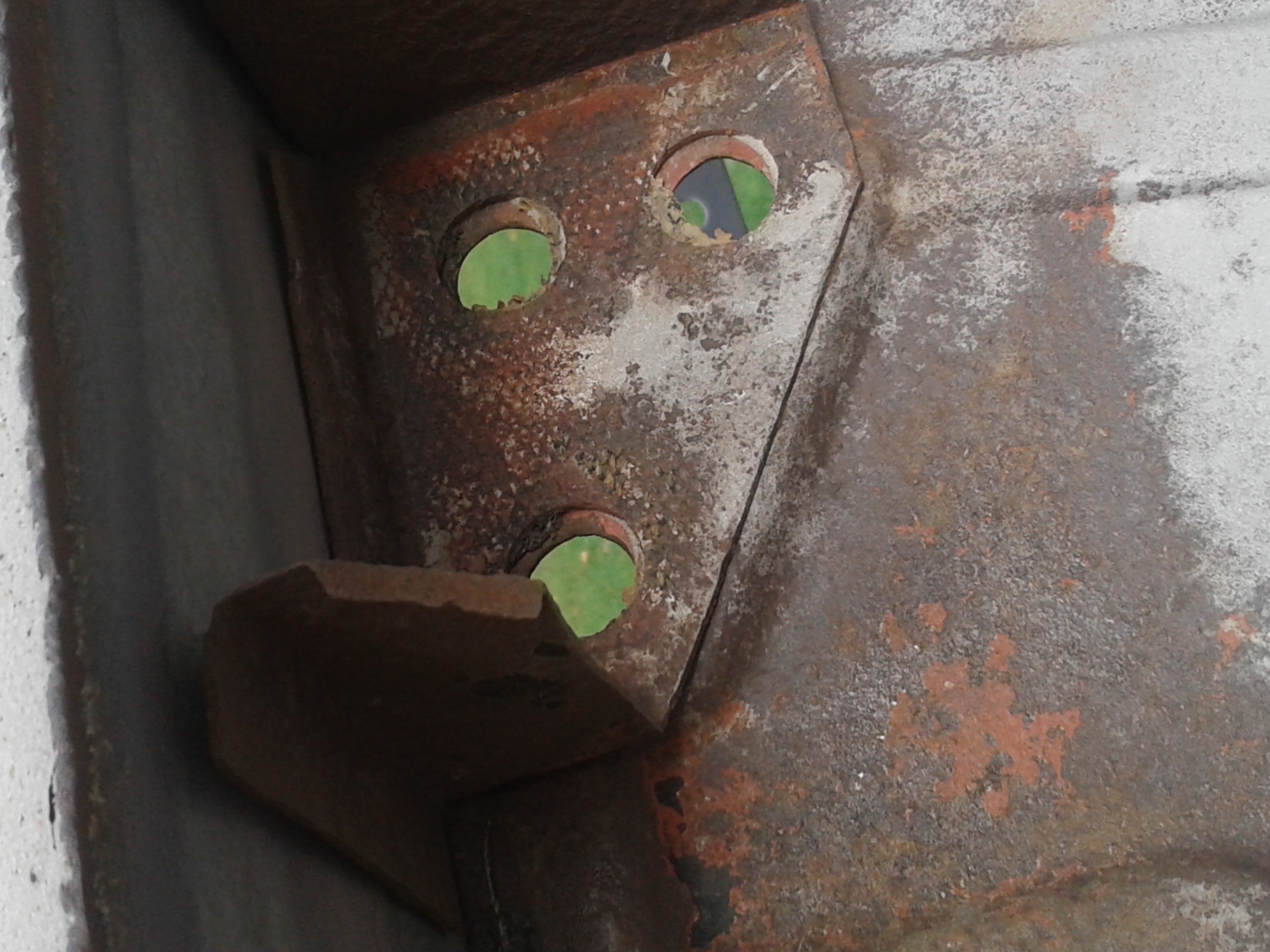

Got one side done. Had to strip the outer rocker. Didn't notice a dent and took a day to straighten out. Plan on cutting out the other side tomorrow. Looks like I'll have to replace a chunk of the floor. Probably an inch and a half by 6" long up in the front corner where the inner seal and the floor are welded together. Rotted out and someone tried to repair with gobs of brazing.
