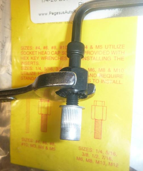

Pegasus has rivet nut setters in fine threads for $11.99.
I ordered the 10-32 and 1/4-28 models:
