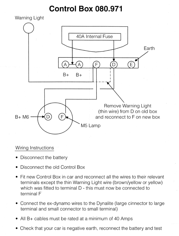

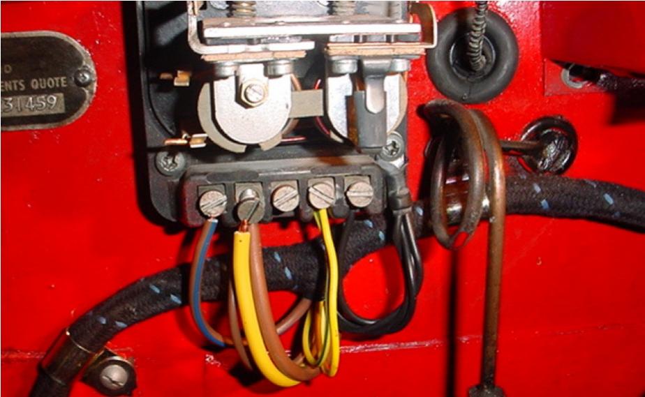

this DYNOAlternator have the internal regulator and came with instructions for use the old LUCAS RB106
for wire connection only 080_971.jpgalt67z.jpg(this photos are for explication only)

Hi - I finished fitting the "Dynamtor" from BB Classics into my 3000 BT7 (Mk II) - it is a straight forward fit - no mechanical nor harness modification etc. required.
It weighs less than half of the original C45 dynamo and delivers up to 45Amps even when idling :smile:
It also replaces the original regulator but you don't have to change anything on the existing harness - just change some wires directly at the regulator and you are done :smile: (Instructions come with the Dynamtor).
You might have to change your belt pulley and fan wheel as the dnyamtor has a 15mm shaft (some Lucas C45 have 17mm shaft) - cheapes place you can get this is in Europe was: https://www.oekoprofi.com/upload/Katalog2013/s331-337.pdf
But probably you can also get them at rockauto.com/ ... it was a very common part.
So I can fully recommend this solution !
