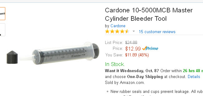

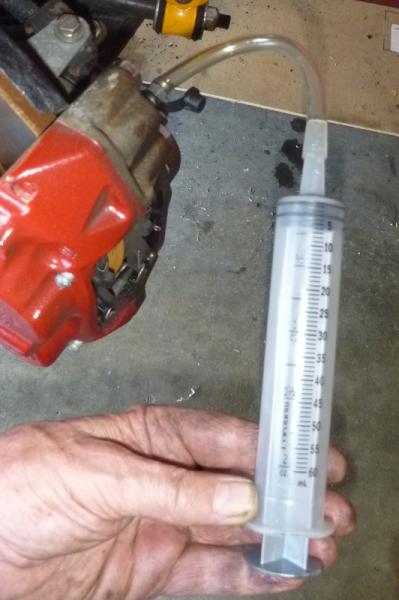

I'd use a turkey baster to remove the fluid from the old reservoir, then remove it along with its supply pipe. Then install the MC; then install the new reservoir to the supply pipe; install the MC in the car; install the supply pipe and reservoir. Install the flex hoses. Wrap all 4 bleeder screws with teflon tape and tighten up the rear drums. Then bleed.
I've used this syringe several times to pull air out of the system and clean fluid through. It completely removes the need for bench bleeding. Keep hyping it because it makes bleeding really easy.
