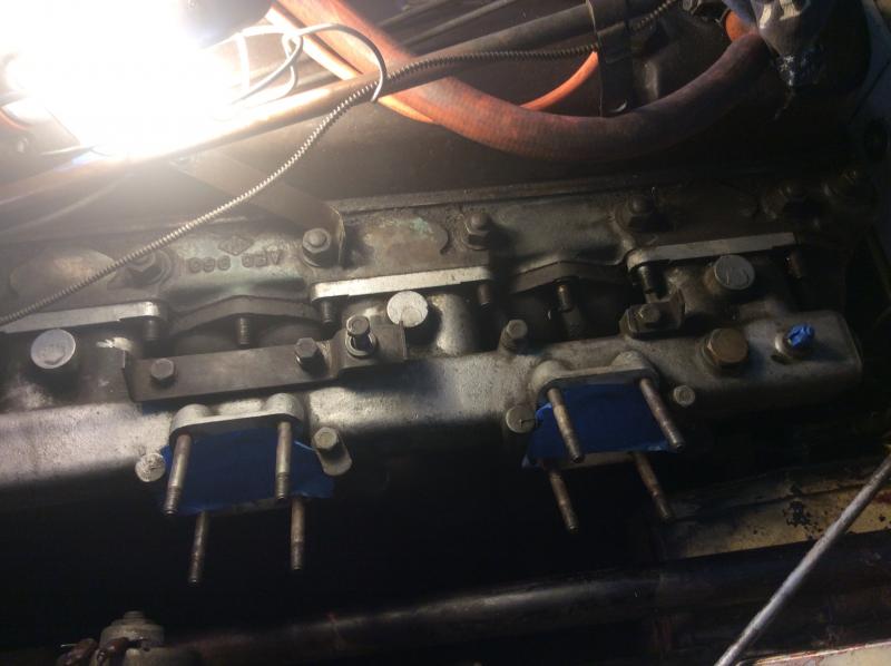

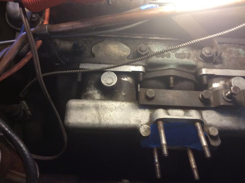

The first time I have attempted to remove the Intake and/or Exhaust manifold on my BJ7.
The only reason I am trying to remove is I wanted to install my Moss exhaust but the down pipe connection to the exhaust manifold I can’t break free. Tried everything, PB Blaster, Seafoam, 50/50 Acetone and ATF and lastly heat but it was so difficult to get to I decided to try and remove the manifold.
I have freed the nuts on the Intake manifold (read it is better to remove it also) but can’t get the manifold to break loose. Being new to this I am worried I will crack or break something. Any guidance on next steps would be appreciated. I will attach photos of my progress and the exhaust I am trying to break loose from the Exhaust manifold.
Thank you for any help. FYI I am rebuilding carbs and that kind of started the whole mess.

Hi Bryan,
In your first picture look at the front carb area - there is a vertical bolt head just to the rear of the carb mounting flange and just towards the head there are two vertical bolt heads going down thru a bracket (possibly throttle linkage?). Now look at the rear carb area and see the same three corresponding bolts..... These all go down thru the intake manifold into the exhaust manifolds. You will need to remove those six bolts to separate the intake from the exhaust. Then remove the intake first, and then you can free the exhaust. Moss catalogue has a pretty good exploded view showing the bolts.
As to getting them loose, you may need to tap the manifolds with a soft mallet or sometimes drive a screwdriver into the gap where the manifolds meet the head - but be very careful/gentile if a gasket surface is affected.

If I was going to remove them, I think I would probably separate them. However, the first test I would do is try loosening the 6 bolts - I think they go into tapped holes in the exhaust manifold but
may go thru and have nuts on the bottom.
Either way they may be rusted too so they might be difficult too. I've got headers and it's been awhile since I've had the stock ones apart.

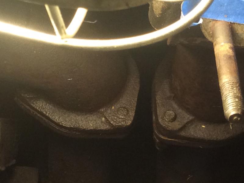

Be careful removing the vertical bolts that connect the intake and exhaust manifolds. It's possible to break them off in the blind hole. Go slow, use a lot of penetrant, and when they move turn them out a bit, then turn them back. Work them out gradually until they turn freely. Use anti-seize when reinstalling them.
Thank you to everyone for their advice. I was able to remove both Intake and exhaust manifolds. Does anyone know the original color of the exhaust manifold. I would like to go ahead and paint if necessary while I have everything off.

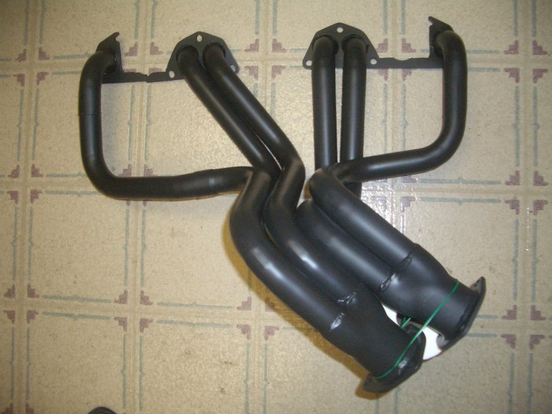

At the time, 2007 ish, Kirk told me they were no longer making the Healey headers. The ones i bought were returns from a customer who said they couldn't install them. Cost was around $170 but they were used. Probably around the same price for ceramic coating inside and out. I had no trouble installing them - a bit of a fiddle but doable. Info on my gallery.
Maybe they either make them again or maybe you can special-order them.
I installed my DMD manifold at the same time as the headers and the combination provided a noticeable seat-of-the-pants increase in acceleration.

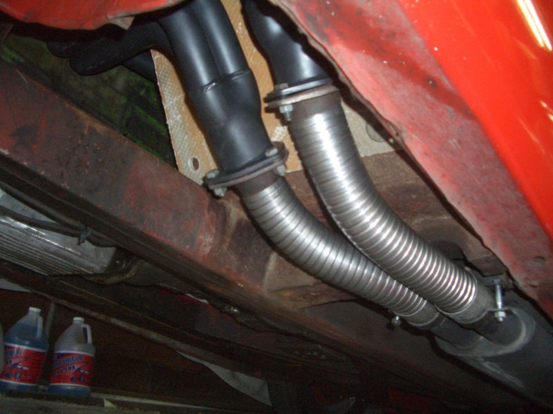

I used stainless flex pipe (from JC Whitney) to make connectors between the header collectors and clamp connectors to the front stubs of the muffler. These are in-place mockups before welding.
Later I added bungs for O2 sensors on the downstream side of each collector flange. They're at the 4-o'clock position but it hasn't mattered as I live in a dry climate.
