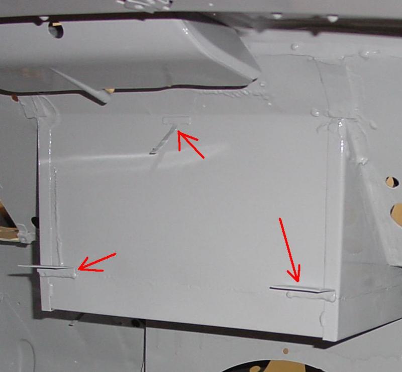

I have a Moss-sourced replacement battery box which didn’t have the dash board support tabs on them. (I hear the TRF ones do...) Could someone run out into the garage and measure the distance from the bottom of the battery box to the horizontal part of the bracket? Sure appreciate it!

Mine is not from TRF and do not know the source. But mine measures 1-3/4" from top of bracket to bottom of box.

I copied mine from the original that I removed from the car. Mine also measures 1-3/4" from top of bracket to bottom of the box. Frank
