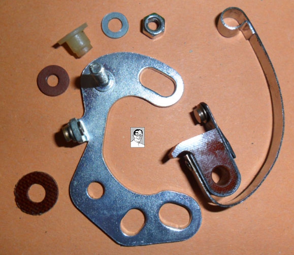

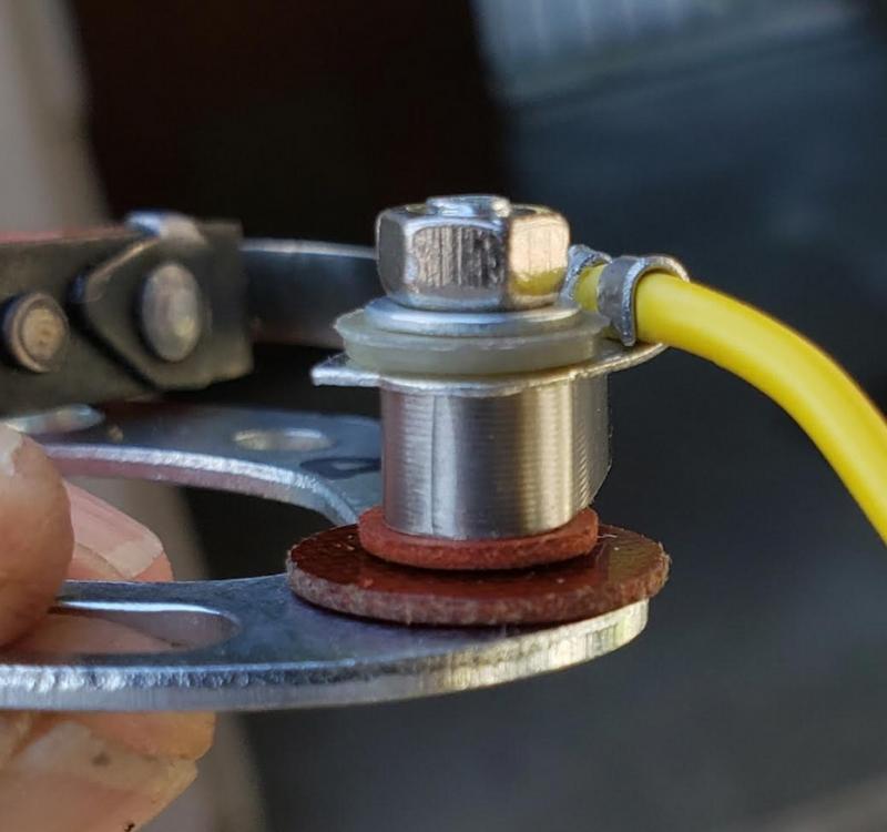

I bought some points and condensers from Distributor Doctor. Rather than having two "hats", they have a single hat and two fiber washers. The larger one almost fitted over the stud base; enlarging the hole slightly did the trick. The smaller one fits over the stud itself and functions as the other hat would, keeping the spring away from the grounded stud.
I can't see any need for the larger washer. In my pic it could be as easily left off. Anyone know differently?
Duh - answered my own question - the larger washer goes under the rubbing block on its post.

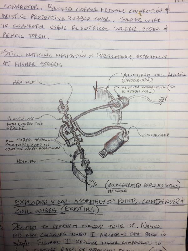

I am not savvy when it comes to electrical, but I recorded what I presently have as a points setup when I purchased my current Healey just over 7 years ago.
I always refer to my drawing when I change my points or perform a complete tune up. And I am only using my setup since it hasn't done me wrong before, so, I don't bother trying to be creative.
Not sure if I do have a secondary washer as you show. I'd be curious to know if what I show is, in fact, correct or appropriate. But, again, I never had any issues of any kind so don't fix what aint broke?

I left the bottom insulator off once on a Jag, took me a few hours to figure why it wouldn't start.

IT appears lik the required bottom insulator { WASHER } is there U just did not identify it on your drawing?

OK, I think you're right. I didn't identify that particular washer and below that, a "do-hicky" cylindrical piece I will now have to go back and identify again.

I recons so coz with out it you would have been in the LARRY K crowd-LOL

Paul, nice drawing. A man after my own heart! I was in Melbourne a few years go after attending the Phillip Island Historic races. I had to replace the points before heading home but in haste I assembled them incorrectly and I had no spark. Took a while to realise my error! I now carry a diagram showing the correct method. Every time I fiddle with the points I remind myself that I once fitted new points in the middle of the Nullabor Plain with a wind howling, uninterupted from Antarctica!

steveg
steveg
The takeaway: the spring with moveable point is an electrical connection from the primary wire and condenser to the grounded point.
Therefore there must be no grounding before the current gets to the points.
