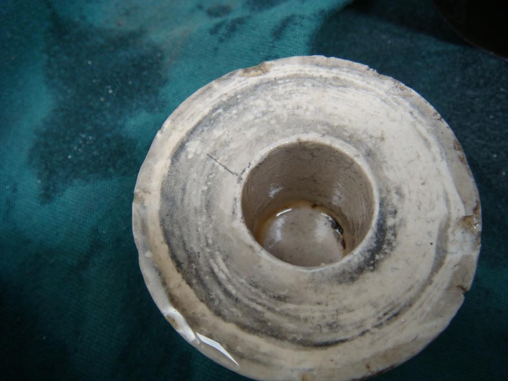

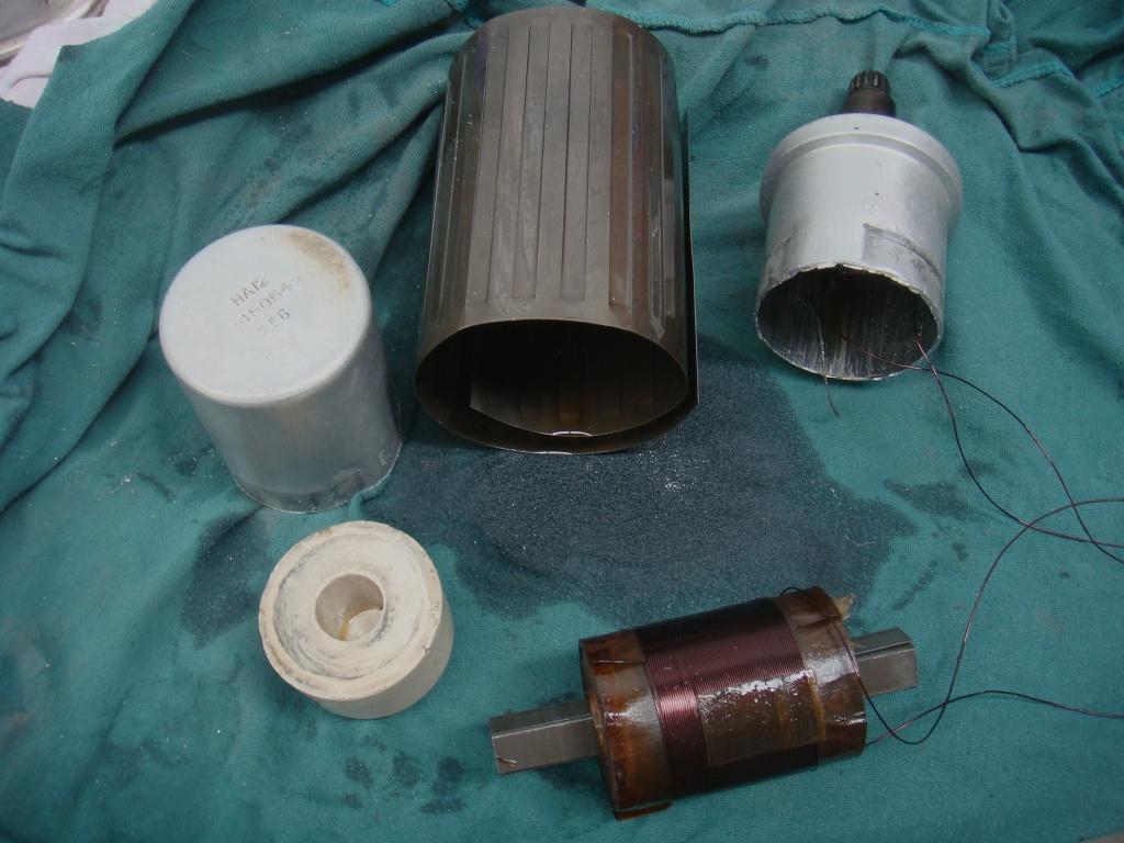

Both cars I currently own had original coils and when fitting the Pertronix both coils failed within a few days.
The Healey coil lasted less than an hour then completely quit during gentle acceleration with a cold engine earlier this year. I could hear the coil clicking internally when turning the distributor shaft against the advance springs to cause the Pertronix to operate. The failure was due to carbon tracking between the HT and LT circuits across the ceramic insulator which you can see in the second pic as a black line at 10 o'clock. The line rubbed off easily and the coil would probably have worked again for some time until it formed another track. The Pertronix makes the coil work much harder than the points do because it switches off almost instantly (this is why the engine runs so much better when cold) which causes the HT voltage to rise more quickly and to a higher level so any existing weaknesses will be discovered as happened to this coil. It would probably have continued on for years with points.
If you plan on carrying the original points in a bag in case of Pertronix failure then be aware that it isn't a five minute job to refit them as the base plate needs to come out to refit the terminal block plus the timing setting is quite different between points and Pertronix. Buy two units and carry one as a spare plus a spare coil and you are good to go anywhere. Too much hassle for some people I guess but the improvement in performance is well worth it for me. Andy.

Steve- I have a regular Lucas coil from the 70s in place at the moment and a spare Bosch GT40 which I plan on cutting open and swapping the guts into the original Lucas housing then welding up the cut which will be hidden under the clamp and hopefully nobody'll know. Andy.
