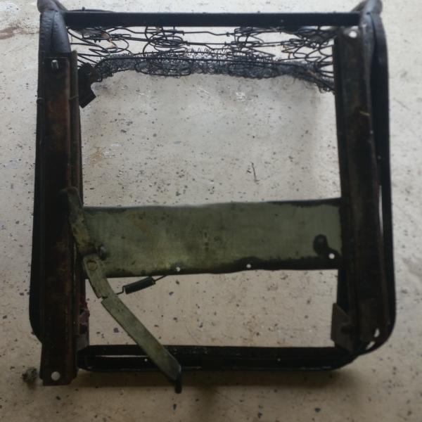

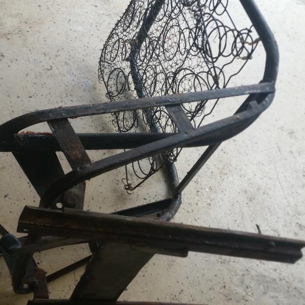

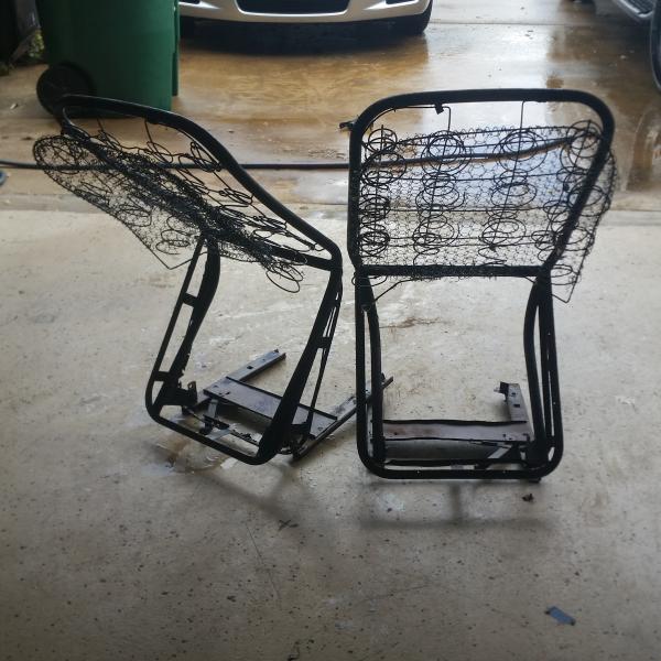

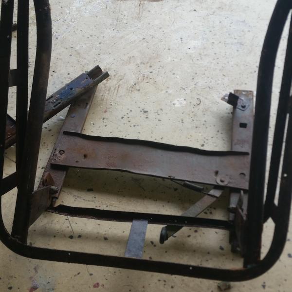

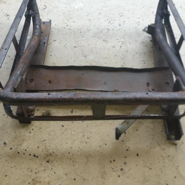

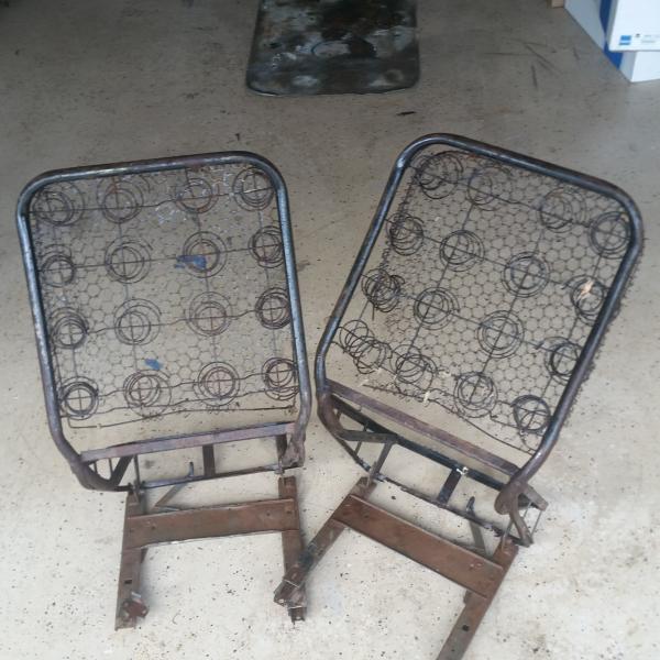

I would like for your assistance in identifying these two seats that I removed from my 1962 TR3A. What I do know is that they are not TR3 seats. Both of these seats seem to have TR4 seat rails but I may be mistaken, and both seats tilt. Your assistance is greatly appreciated. Hope the pictures help.

Not like the earlier TR4 seats but they do look just like my Herald seats. May be Spit or GT6 also. Tom

As I understand the Brits used pretty much what was on hand back when they built these early model cars. Is there any possibility that these seats were original in a TR3a?
TomMull
That possibility is as close to zero as one can get. Tom
Andrew Mace
Sorry I missed this for so long. Most everything matches up nicely with circa 1963 or later Triumph Herald seats; at least the seat tracks do. Honestly, in 50 years of being around Heralds, I've never had a Herald front seat down to the bare frame...but the shape looks about right!
