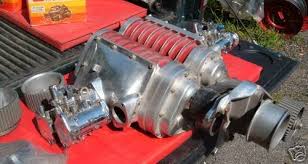

I can not even find pics of the finished 5.2 I will ask my machinist to send some.

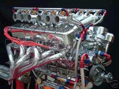

I am attaching something interesting that Phil Baker built. Yes I was in communications with him when he was building this.
Also my 220 for my DZ302 BakersV12.jpg220.jpeg The magnacharger 220 CID displacement & Phil Bakers 482 CID V12 built from 2 Rover Blocks!

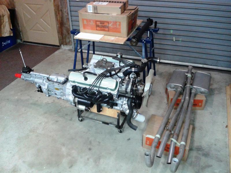

bob67bgt
After purchasing a TR8 and feeling the great torque of that engine I purchased a 215 for my rubber bumper BGT. Townsend sounds like the place to be!
