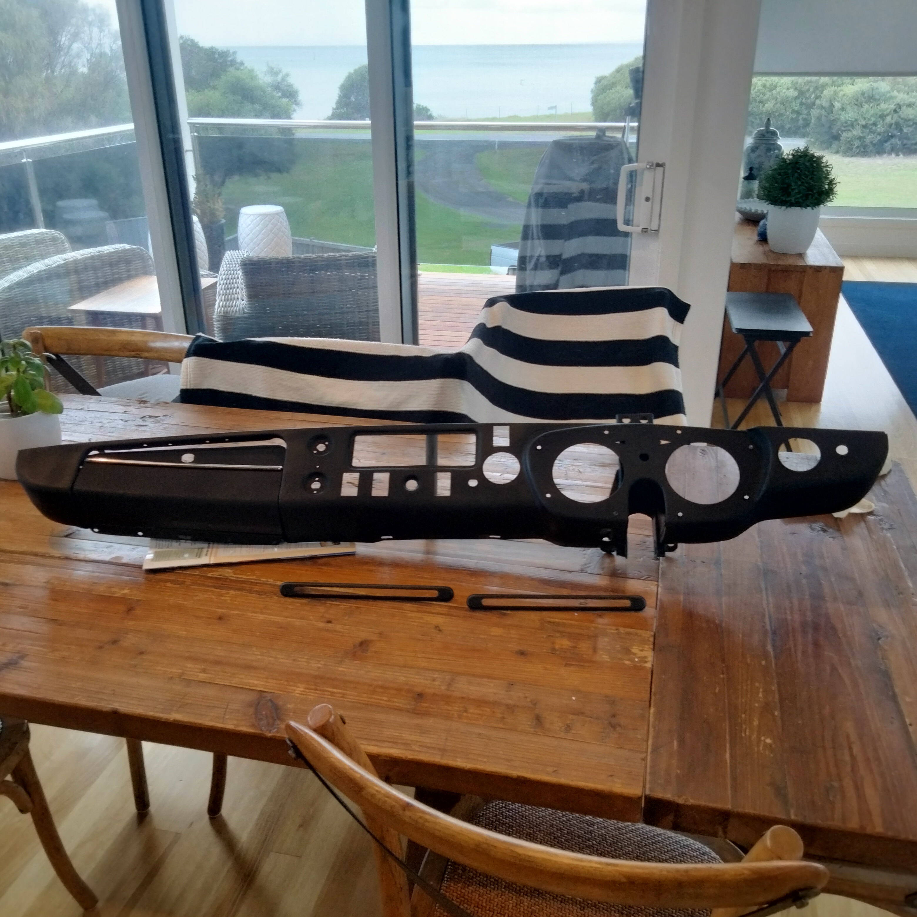

Just finished painting dash, glove box door and vent grilles with Duplicolour wrinkle paint. Didn’t have oven big enough to put the dash in so used heat gun and slowly moved along as it dried took a while but happy with the result now for putting it all back together.I also used Duplicolour vinyl and plastic paint on dash Pad, centre consul and side covers they came up really well.

Looks really good, Chris. Nice work!
Me mum didn't appreciate me usin' her oven to heat up a flywheel ring-gear back in the sixties, so mebbe it's better the dash didn't fit in the oven. 😉
For the small steel "dots" to indicate where the index on the heater control knobs are set, I used a couple small stainless slot-head screws ground and polished to eliminate the rust issue on 'em. Down here in Florida, the (salty) humidity is hard to beat back. Those steel rivets would look awful in a few weeks.

My wife is in Melbourne hence the dash on the dining room table with the heater on to maintain temperature .
I was wondering what to do about those dots, both have a reasonable surface but the spreader legs are broken so you
have given me a plan thanks.

Does the chrome strip on the glove box come off , it would give a better paint finish if I didn’t have to tape up and spray
Before attacking it I thought I would ask the question

I know I took that chrome strip off before painting the door, but can't recall for the life of me just how.
Platinum
The strip is unbent, back in place looking like it should, so it must have been a "non-issue" since I don't recall how I did it. As it was removed before painting I'll assume it was gently pried away with little worry over scarring the old paint, rather being more conscious of twisting or otherwise damaging it.
The chrome strip has spring clips which slot into holes so just a matter of easing it off with small flat screw driver.

Good! Likely the removal didn't stay in memory due to ease of the task.
