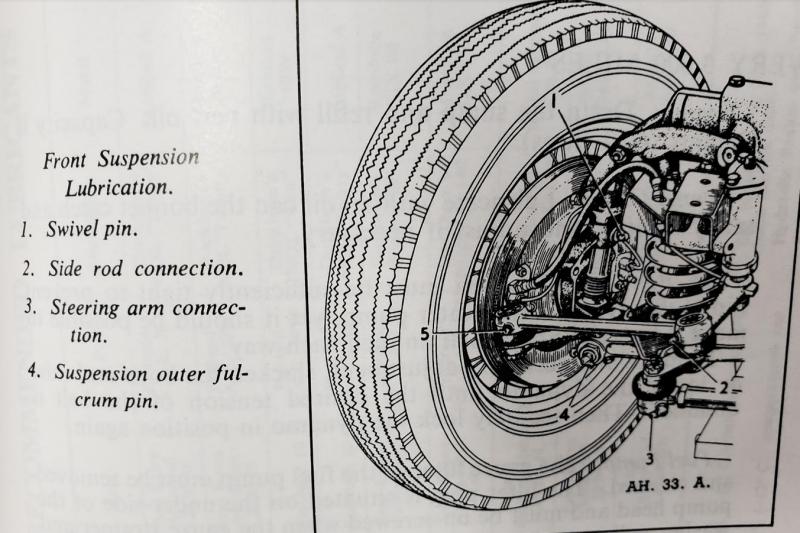

I would appreciate it if someone would please enumerate the lube points (zerk fittings) found on the front suspension and steering on a BN/BT7.
Thanks in advance.
From 100-6 Owner's Handbook, p. 35:
