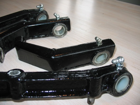

For 45 years or more, the front suspension on my 1958 TR3A produced these horrible squeaks when I was driving - even on fairly smooth paved roads with little waves in the asphalt. It was even worse on rough roads.
In 1990, I put in poly bushes for the first time (80,300 miles from new) and it still squeaked. Everyone told me to spray aerosol silicone lubricant into the ends of all the poly bushings. I did this and it didn't stop the squeaks.
So this past spring, I took it all apart and changed 4 of the poly bushes because they were worn (the other 4 were good) and my neighbour drilled and tapped the inner ends of the wishbones and installed zerk grease fittings. He also has a lathe and he machined a "V" groove all around the inside of all the 8 poly bushes and I drilled through the bushes where the zerks were fitted.
I re-assembled it all and for the first time in 40 years, it rides so quietly, it's like new again. I greased all the 13 original fittings plus the 8 new ones with Amsoil red synthetic grease.
TR3driver
Great Pumpkin - R.I.P
FWIW, you can also do this using a hand-held Dremel with a round burr. I cut my grooves into an X shape, so they would also carry grease to both sides.
