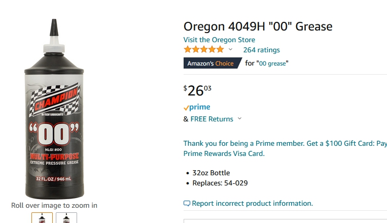

I see Moss has no info on how to load the Dynolite. I've used both John Deere Corn Head NLGI 0 grease and Stens (sold under several names) 00 grease. The corn head injects from a grease gun cartridge with a grease needle injector on the end of the hose. The 00 comes in a quart squeeze bottle, which is pretty easy. You attach a short piece of clear tube to the bottle which will reach the bottom of the box and fill it from the bottom up. Make sure you've turned the wheel all the way to (IIRC) the left so your tube will reach all the way down.
Microwaving the bottle or leaving it in the sun helps liquify it. You fill the box part way, then run the steering lock-to-lock to work out the bubbles, then fill it a little more - until it comes out the upper plug. Keep working the steering until all the air's out. Jacking up the front of the car makes this easier.

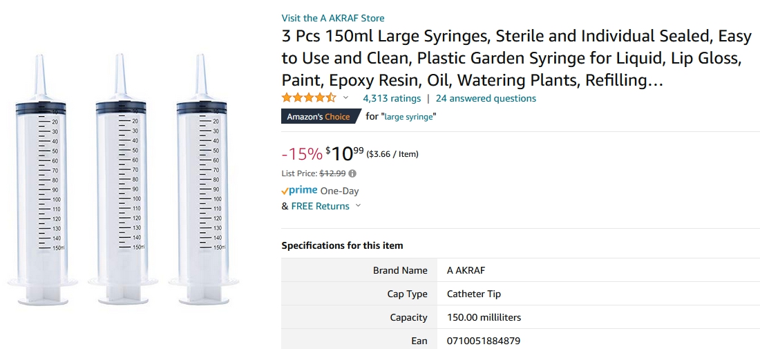

Removing the lid would certainly be the belt-and-suspenders method. The grease fitting on the side might indicate a PO had previously filled the box with multipurpose grease, in which case it wouldn't drain out anyway. If it contains gear oil, loosening the bolts slightly should do it. A plastic syringe from Amazon could be used to pull oil out of the box.
