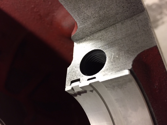

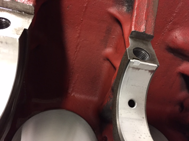

I need some advise on what may be an abnormal problem. I had my crank turned at the machine shop and my block fully dipped cleaned and tested. They turned the crank for .010" over and I installed appropriate brgs. Issue is that the crank is difficult to turn when in the block without any caps installed. I can get it to turn but not easily. When I install any cap the crank is very difficult to turn.
- I verified the clearances with plastigage and right on at approx. .00175".
- I am thinking the bearings themselves may be too large in diameter because there is wear on the bearings at the gap. See pics.
- the wear in the pics if from only several hand turns of the crank. The small one in JPG 336 had not been rotated with a cap installed, only cap installed for plastigage.
I have not assembled an 1800 before but other cranks turn very easily. this cannot be normal??? Crank bent?

What did the wear pattern on the old bearings look like?
You can tell a lot on teardown about issues you may need to inspect later.
You are absolutely certain the caps are set for the correct journal?
And not flipped around?
If they are right (bearing tabs same side usually) and numbers match, take the block back with caps (no bearings) installed, have them check the line with an inside caliper in standard places.
Did this engine run in your presence before teardown? Reason I ask is I have twice in 60 years had an engine brought in for rebuild...and when we got done, main caps were not for the engine delivered, and it was the only engine of that type in the shop.

I would tell you to run it...but I have seen engines with bearing crush area swedged out that overheated the bearings, so best to check it further. Bore check on the line can't hurt, unless they did that.

The bearings should be fitted to the block dry , then lightly oil and lay the crankshaft in. The crank should spin easily and almost effortlessly without the caps . If the crank is difficult to turn without the caps something isn't right with the block or crank. Did they provide the measurement to turn the crank undersize or did you?

I think they would be able to tell if the crank were bent before they turned it and I don't think they could turn it if it was bent , so if its bent now it must have been dropped after it was turned. Or the block is suspect but they'll want to measure . I've rebuilt a lot of B series engines and can tell you I'm only surprised when it goes as planned. All the best!

And...all the Plastigage tells you is vertical. If the bore is squeezed narrow, you won't be able to tell with Plastigage...generally.
Wait until you open an old engine and find feather shims between bearings and block/cap.

I've had problems with a stiff to turn crank on a couple of rebuilds and my machinist/engine builder just hit it with a rubber mallet and it spun freely. Sometimes things don't seat completely and the plastigage will show good clearance, but you'll experience the problem you did.

I had one engine that the main studs were tightened so much that the main walls had hairline cracks in them that when the studs were tightened it caused those walls to push out, which is towards the crankshaft, causing the binding. Easy fix, weld and the line bore the mains.
