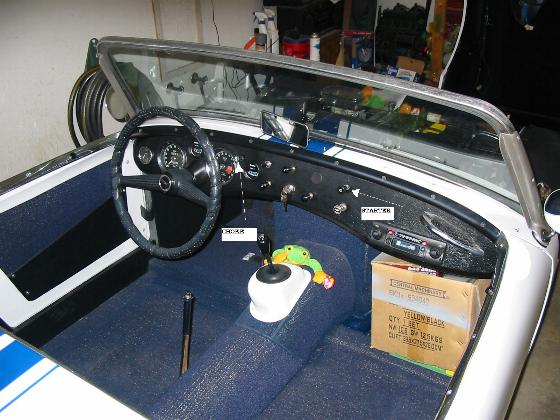

I don't know if there is a difference in cables, but....
The right arrow is where the starter is on my Bugeye and the left is the choke (I can't read the "flags" on the arrows). And you seem to have two more switches than I have (the ones to the left of the ignition switch), but kind of hard to see...
Hope this helps.

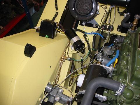

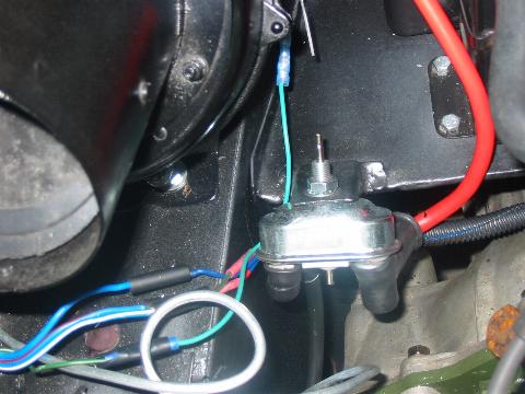

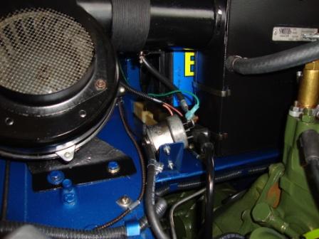

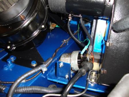

I found out why the starter cable won't reach the solenoid. I was looking at some photos I had taken of a local Bugeye when I noticed the position of the solenoid mount on the other car. Mine has evidently been cut off and repositioned by a P.O.
The photo of the Primrose Bugeye is the correct position, mine is the other photo. At the top of my photo you can see how short the cable is.Guess I'll use a after market cable and paint an " S " on it.

jvandyke
My MK1 Midget has it as in your photo. I don't see the difference between the two, both on the front edge of the battery shelf. The angle of the photo makes it look different but I think they're in the same place?
Ohiobugeye
Ohiobugeye
They both are in about the same location, but my mount sits at about 45 deg. and the other one is straight up and down. You can see the end of the cable at the top of the photo. If it wasn't for the angle of my mount the cable would probably reach. Basicaly same place but different angle.

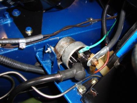

HAN8L1965
Here you go some up close and personals from my 65 I think it would be the same post.

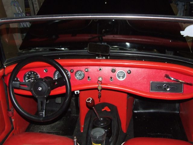

scoutll
Actually, though it may look wrong to the bugeye folks, On the LHD MK1 Midget/MK2 Sprite, the starter is next to the tach and the choke is the farthest away on the passenger side. The Midget starter cable is not a direct shot and is longer.

That was what I was thinking, that the early pull start Midgets had the cable on the left hand side of the dash. Thus needing a longer cable. I see that both the Sprite Mk1 & 2 and the Midget Mk1 & 2 use the same cable to solenoid connector although they have a different cable part number.That answers my original question. Thanks for the info.....Great Photo...Nice Dash!

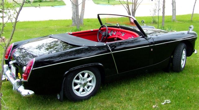

Thanks, I'm glad I could help in a small way. Here is a shot of the rest of the car. :thumbsup:
