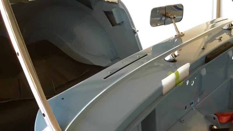

Just painted my B.E. and getting ready to install the dash. Figured I'd install the defrost pluming. All in but at windshield, how do they attach? I have no holes to mount them...

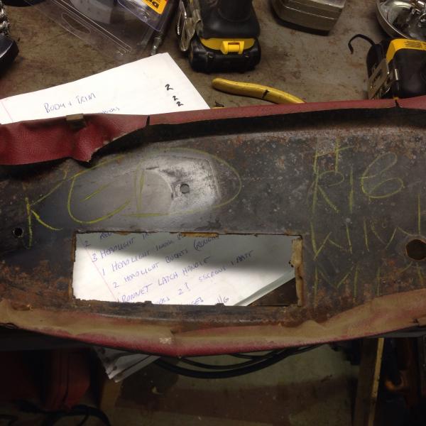

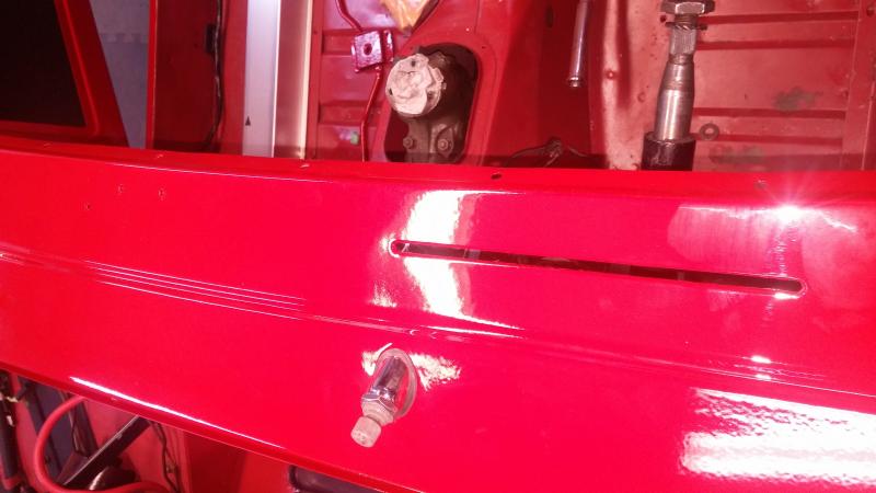

Rut
There should be 2 screw holes for each vent.

T
tim66ah
Thanks, that's what I thought. Now to drill holes through my new paint... This car appears to never had them installed as well as no washer jets. It was an Oklahoma car from new.
Rut
The heater was an option and I don't know if the holes should be there regardless. Look under the cowl and see if there's any evidence of previous holes. You may want to investigate another way of attaching your vents if no evidence of the original holes can be found...possibly a strip of wood or Starboard glued to the underside, slotted and drilled to accept the screws holding the vent. We use this technique quite often on boats to mount things on fiberglass when using 'wood' screws.

JPSmit
Is there enough flange to even use 3M type trim adhesive?

tim66ah
Thanks for the ideas. I looked underneath and no holes ever existed. Should I leave the heater out? I only drive in the summer. When it's cold enough to need heat I put will put it away for the winter.

nomad
How hard is the paint?? You might be able to use a small tube that has been sharpened to cut through the paint and keep it from chipping out when you drill the holes. It would require a test in a spot that isn't going to be visible such as under the cockpit trim.

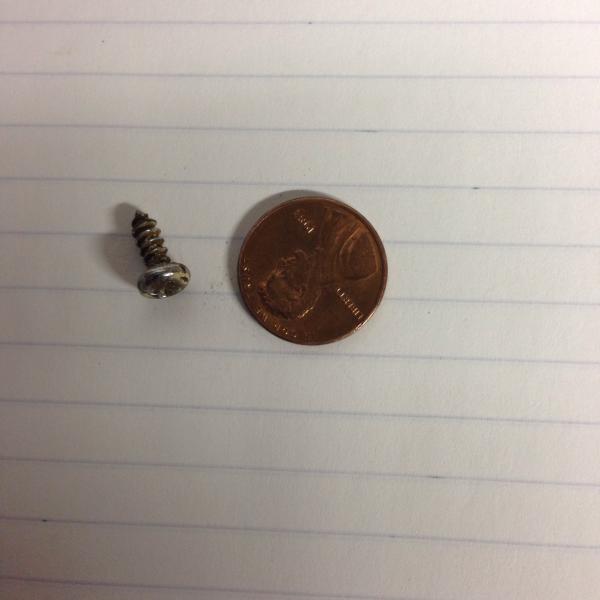

And questions for my stuff:
- with a British Heritage certificate, do they advise what options a BE would've had?
- can anyone advise as to the type of screws (thread pitch; diameter, anything/everything) that were originally used? AH Spares doesn't list them and I'll be danged if I know where ours ended up. I was thinking of drilling the plastic vents and through bolting with something (ideally stainless) that duplicates the original head design.

Rhodyspit75
I have just bought a 1960 Bugeye. But have been on the Triumph forum for several years. I just went out and removed one of the screws and it looks to be a # 6 Phillips head sheet metal screw about 3/8 inch mine were painted but look to have been chromed originally.
The options are marked on the back of the dash. Mine has an H I believe it means heater.

JPSmit
won't be phillips it will be posidrive but, at that location and that size, I can't imagine anyone but a complete fanatic would see the difference
