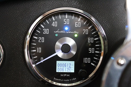

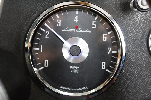

But the Gauges in a Box Sprite are a different Size than in a Bugeye. You can get custom gauge faces from Speedhut for a nominal fee. And if you get on the Speedhut Mailing List they run 20% Discounts on holiday weekends. Measure the size of the openings. Something tells me that Spridget Gauges are 4" and Bugeyes are 3.5" Measure please before you order. Here are pics of my Speedhut Gauges. Bugeye Guy has a customized Gauge Face but you may be able to get from Speedhut. These look really good on my new Red Dash. Speedhut Speedo.JPGSpeedhut Tach.jpg

Thanks Bill, my first Sprite was a ‘68 with a padded dash. That’s why I was confused. I added a few options to gauges including on the Speedo a blue led for bright light as well as Green LEDs for L and R turn signals, as well as the Austin Healey Script. The tach got a red generator/alternator lamp remember you need an analog bulb in the line going there as an exciter for the a,ternator / Generator before going to the LED. And again added the Austin Healey Script logo. The center disc is one of the options you can choose. David’s is si ply a little larger I think than standard.

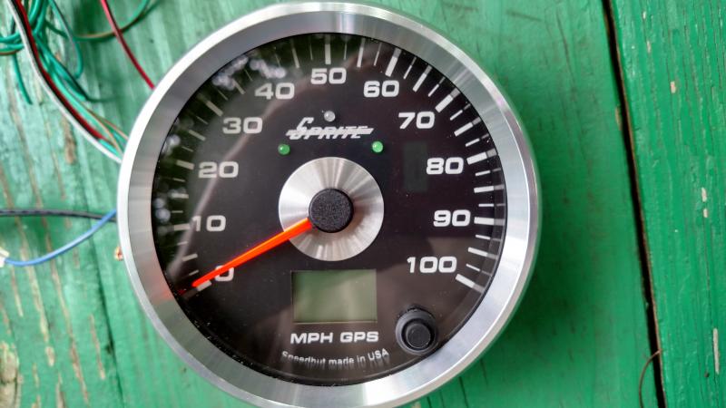

Here's what I came up with from Speed Hut. I picked a different logo. But if the ones from Bug Eye Guy fit, I'll probably go that way.
I don't see a way to add the charging light to the tach.. Hmmmm.
However, if I read the message from Bill M correctly, Bug Eye gauges and Mark III gauges are the same size, 4" and I'll probably go with the ones from BugEye Guy.

Let me pull my dash off the shelf in the am and measure for you. I can unscrew the tach easily and measure the size of the opening. I might have ordered 3 3/4” size. The logo I just pulled off of the internet and sent them the file. They photoshopped the image to make it fit and so there was room for the LED’s to look nice. See if they can pull up my order in their files and copy the artwork if you like how it looks. Hmm order would have been in 2017 I think and I still lived in OH. See if they still have this artwork on file. I’ll check the opening size in the am for you.
