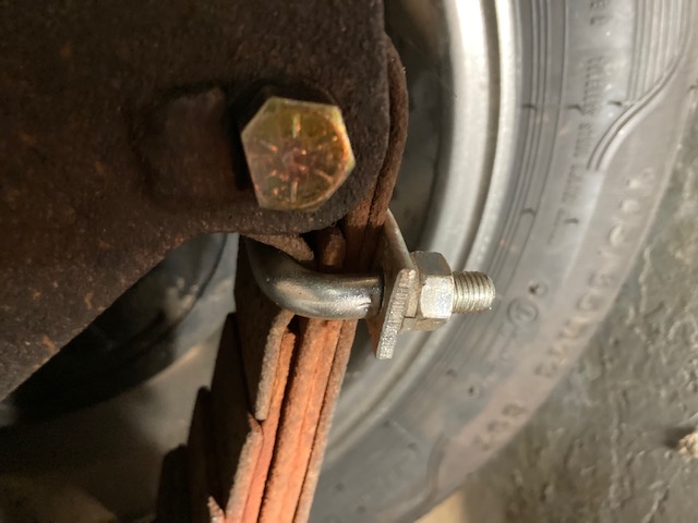

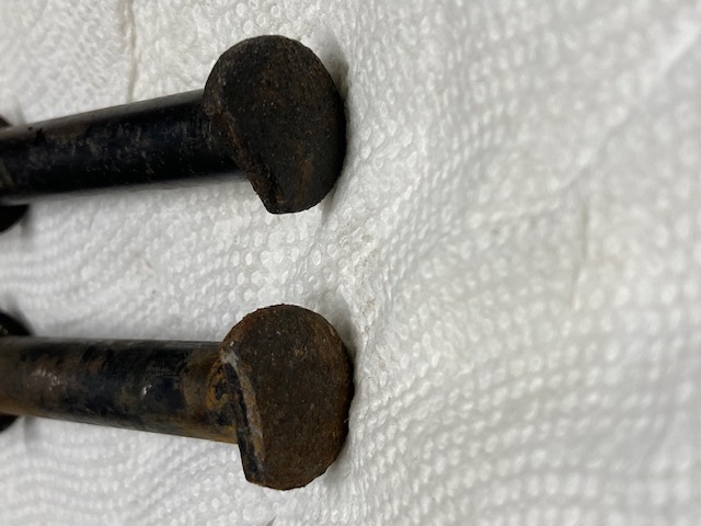

I picked up replacement hex head bolts at a machine tools and hardware supply company locally. Keep in mind that you will need to flatten one side of the hex head using a bench grinder (or equivalent) in order to allow the bolt to be locked into the built-in tab on the axle housing upright.
Photos below of the original and new bolts.
