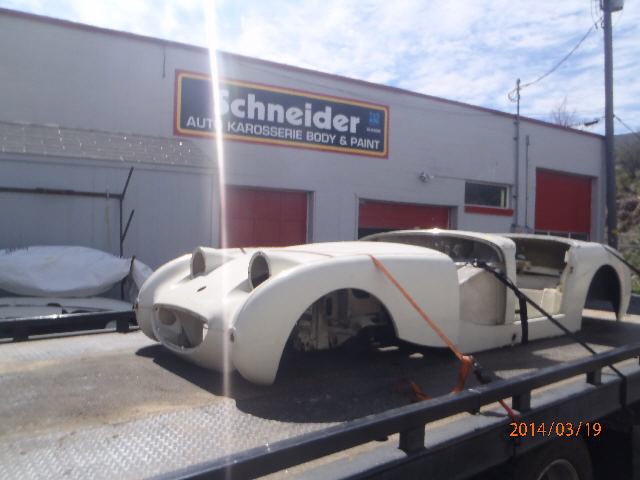

Over Thanksgiving weekend that same year I disassembled the car to get it ready for the necessary bodywork. Found a reputable shop and off the car went for bodywork.

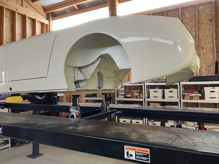

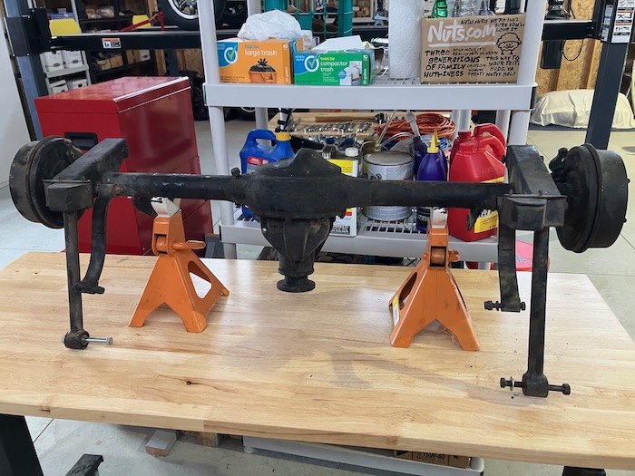

I made actual progress today! Rear axle and suspension is off and on the bench for rebuilding. A Spritely advantage is that the rear axle is light enough to remove with one person without doing any back damage. Was sure nice having the lift to work on, no more crawling around on the ground.
The rear of the car is up on some combination jack stand/bottle jacks, perfect for use with the 4-post lift. Just had to run a 2x4 across the car and could use the spring pans as the jack points. The Unijacks lock down like a standard axle stand so they're not resting on the jack portion, pretty neat. Car is light enough with no drivetrain that I did loosely tie the front down, just in case.

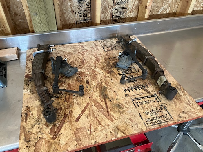

Next up is to refurb the springs and send the shocks off for a rebuild. Question: should I fully disassemble the springs? I've got new bushings and u-bolts, but wondering if I should pull them fully apart for cleaning/painting or if that's not really worth the effort.

I'd be inclined to leave the springs as is unless they are squeaking. Looks great!

I'm thinking the same, JP. Just a clean up and replace the bushing at the end and call it a day.

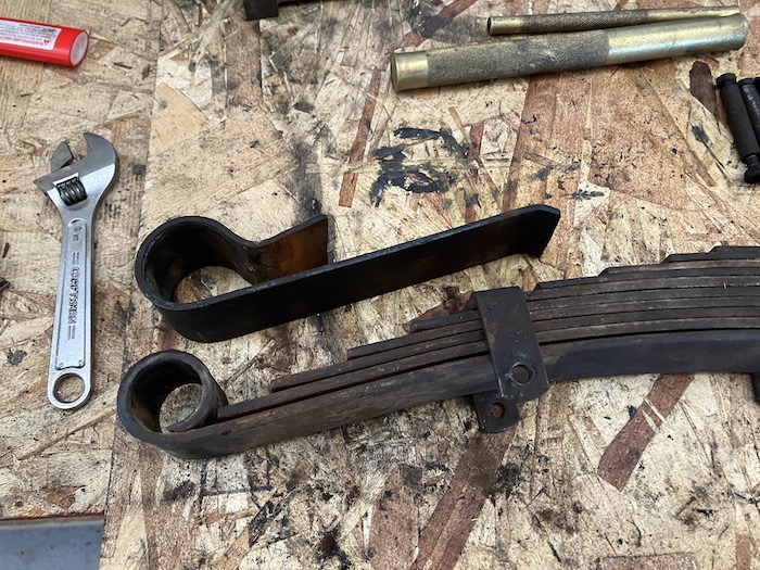

Made a little progress today, got the left side spring partially disassembled so that I can replace the bushing on the end. If anyone has any great tips on getting that old bushing out I'd love to hear them. I'm assuming it's been in there a long time. I do have a press, but wondering if I need to cut/burn it out somehow given it's likely well and good in there.

I've done this a couple of times. I've used a 20 ton press successfully and I also used a torch to burn out the rubber bushing. Both worked successfully. Some lubrication will help the press to push out the bushing.
Re. Disassembling, looks like you got the mini U bolt off successfully without snapping it. That's a major win. I used Electrolytic Rust Removal to get Spring Stacks apart several times. A Battery charger, Arm and Hammer Washing Soda, A sacrificial anode, large plastic container, Battery cables, Water and you can immerse the spring and connect up the charger. After a day or so, Springs will come apart and the center bolt can be removed.
Other alternative is disassembling stack starting with the small leaf. Get a few of the spring leafs off and your press will push that center bolt out without an issue. Wirebrush the springs and maybe a flapper wheel on the angle grinder and they will clean right up. I want to local Tractor Supply and got some Slip Coat/Cote a graphite based type of farm implement paint. The graphite allows springs to compress without squeaking. Paint dries a very dark grey. If you want it black will need to overcoat. I've disassembled 3 sets of springs, 1 using Electrolytic Method and 2 with Press and wire brushing. Less mess with the later.
When you put this back together don't forget to replace the radius arm rods. Bushings are brazed into place and it was simpler to simply replace with new. Get Peter C. to send you a set of his best rebuilds, don't forget which side the spacer for the radius arm bushings goes on and you are good to go.

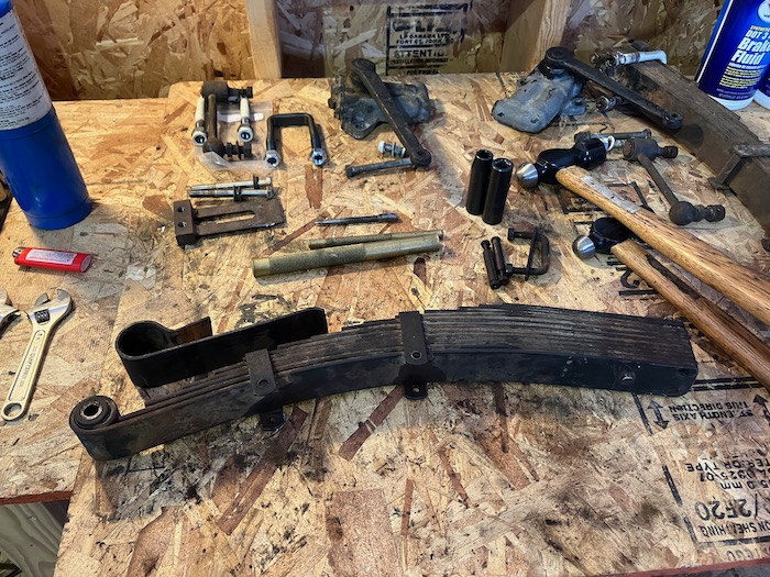

Bit of progress. Was at a tech session yesterday, helping someone in our local club set a TR6 body back on its frame. Once that was done, I got some help to get the bushing out of the Bugeye springs. Now I have to decide if I'm going to disassemble the springs, or just clean them up as is and do a bit of exterior paint.
