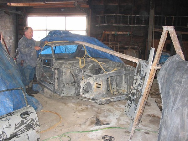

The name of the shop is ACP metal cleaning. Dale Triefenbach is the owner/operator. His shop is located in 308 S. Jefferson RT 163 South, Millstadt Ill. Not far only about 15/20 min. from South St Louis over the JB bridge. You can reach him at 1+618-476-3500. Good luck.
Johnny
I doubt you need to worry about annealing the steel. After all, parts are welded at much higher temps. I was told that any type of spring left on the car (not leaf springs but coil type springs) may loose their "springy" after being heated. Don't forget, there's springs in the door openers even under the hood latches etc. Click above under attachments for a picture of the process.
