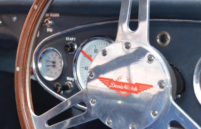

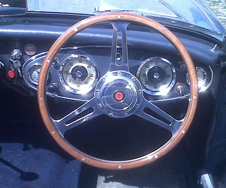

DerekJ
I would take the opportunity to remove the trafficator altogether. Although it is an interesting piece of antique Bakelite IMHO it doesn't belong in a sports car. It is fiddly to install and use and looks like it belongs in a 1940s family saloon. Move the horn and indicator to the dashboard and fit a nice alloy blanking plate. Another very clean option is to fit a Motolita horn push and just move the indicator to the dashboard.

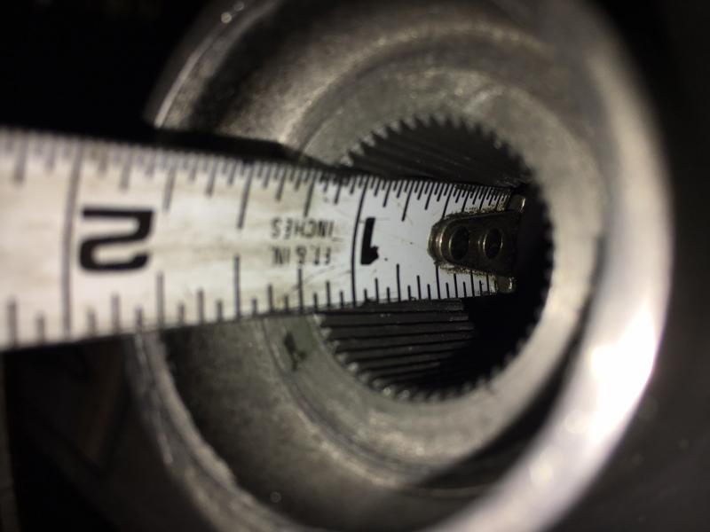

I recently put a Lempert Wheel in my BN2. I found that the 'Lempert' hub--which is actually made by Mota Lita but modified by Mike--has a slightly longer splined section:
Mike said he hadn't seen--and/or didn't know about--this, and I didn't get quite as much thread on the big nut as I would have liked, but it worked.
