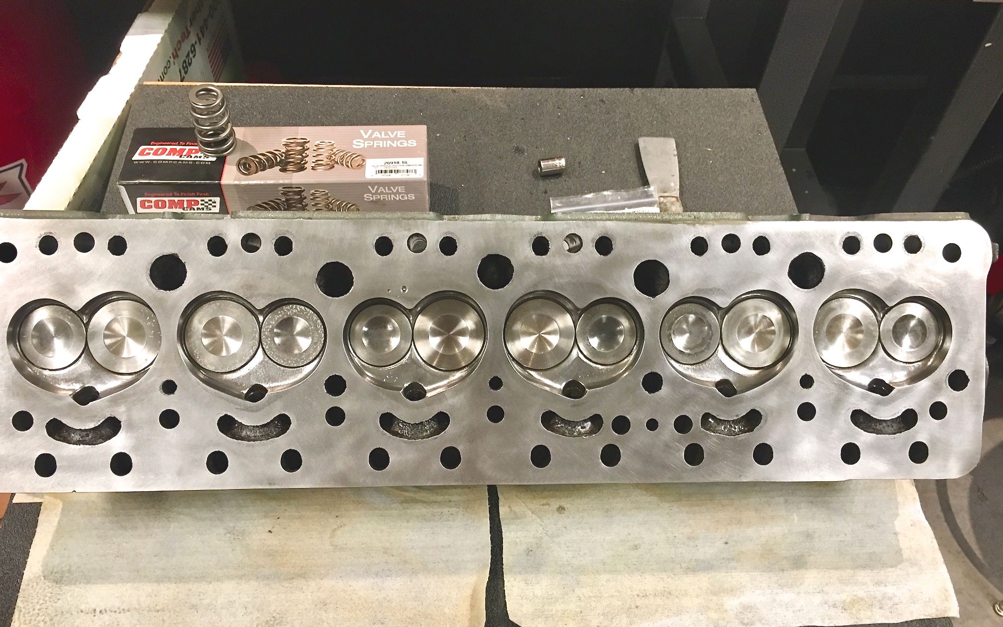

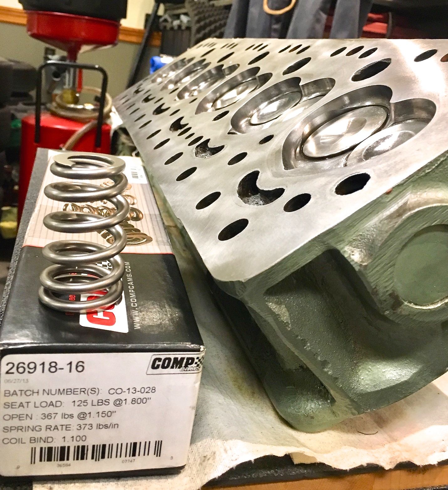

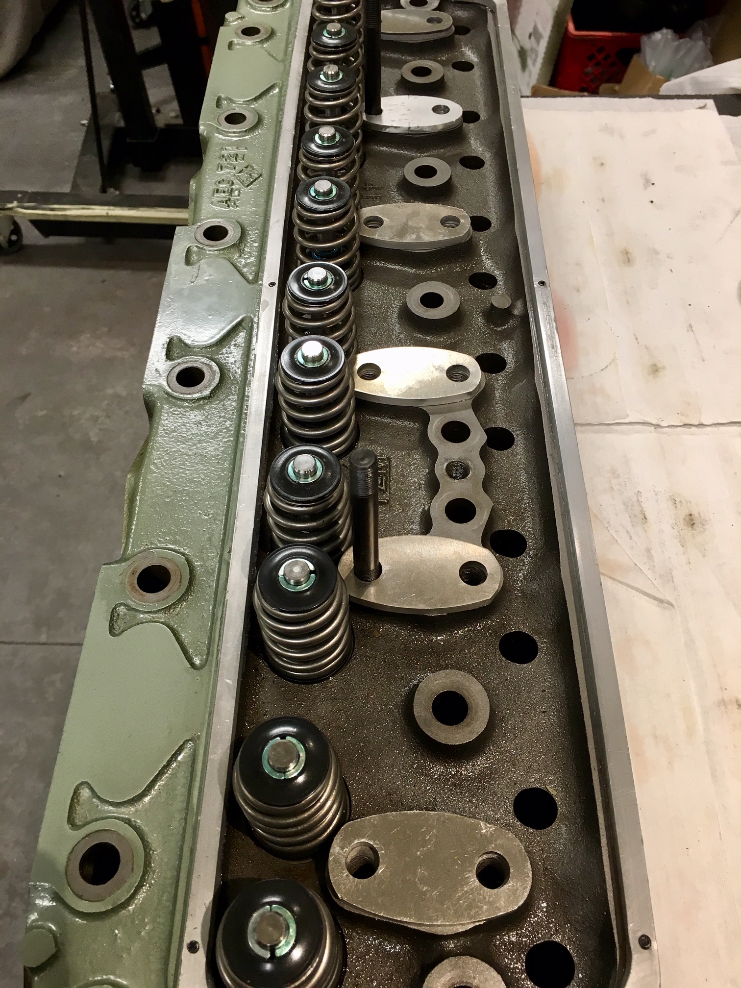

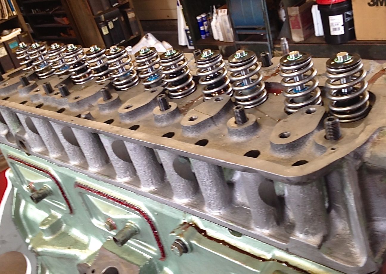

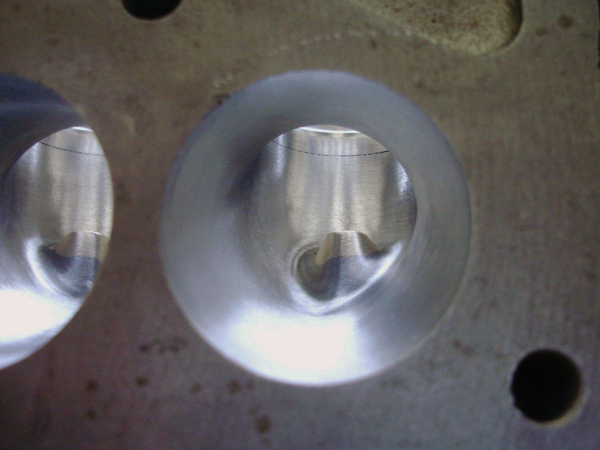

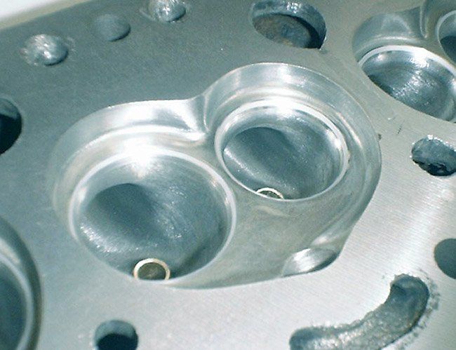

Hello Jere -
I moved away for DWM motor parts years ago due to the expense and suspect build quality. I've been using US high quality Comp Performance Chevy LS valves & heavy duty beehive springs in all my race motors for years. It just takes an easily made spacers to accommodate the additional length. You'll gain all the power you'll need for a street performance Healey 6-cylinder with a BJ8 cam and a proper ported head. I ran my first performance street/track motor with a BJ8 cam & twin SU HD8's, proper ported and and valve train. It made made 200 hp at the wheels and was very streetable, although a loud for the neighborhood.....

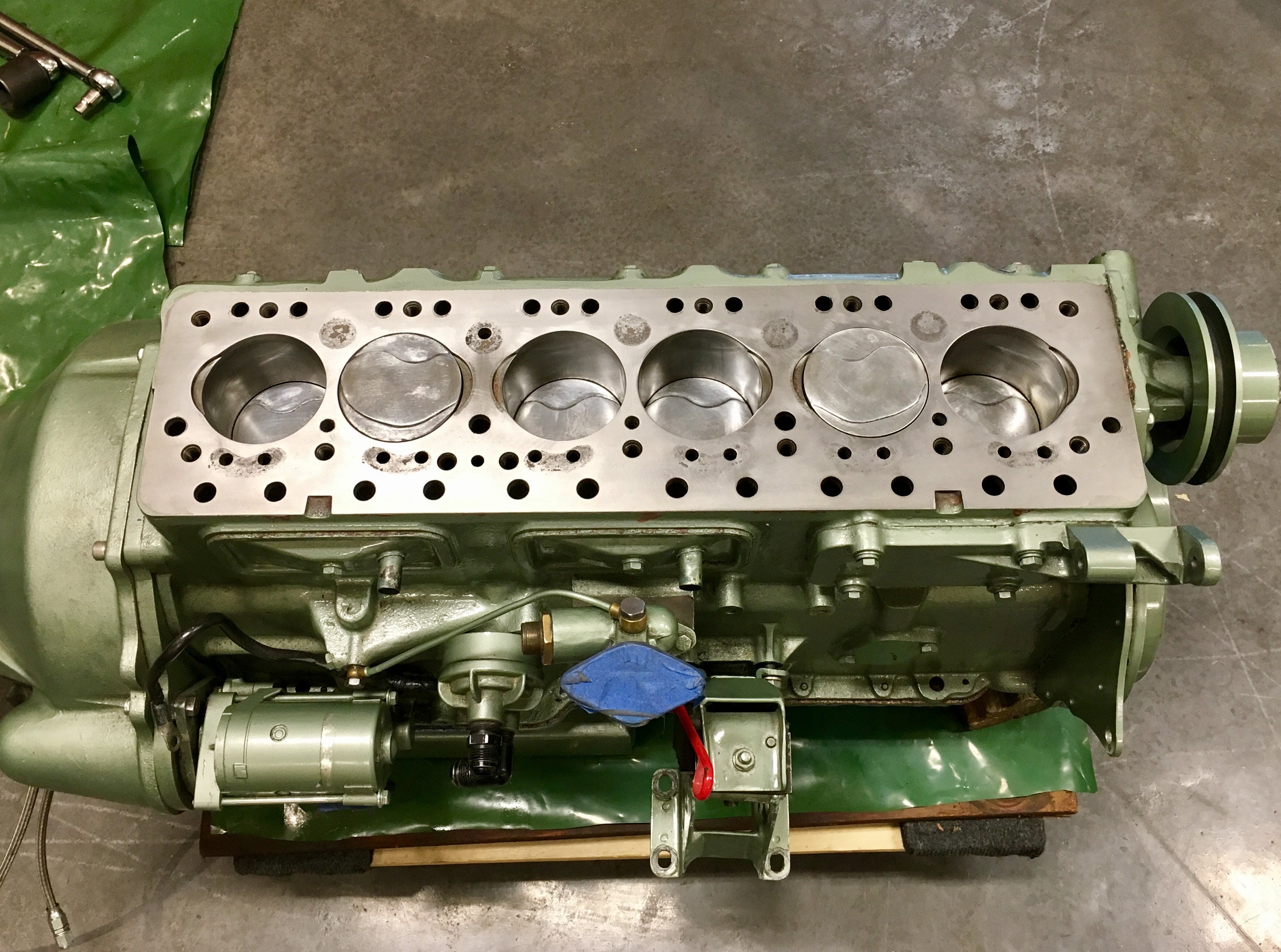

Dougie, I’m just wondering if you decked that head and cc’d the combustion chambers and if so, are you willing to share the numbers you used?
The iron head pictured is one of my older units it was just very lightly decked to clean-up any uneven areas. Its at 50cc, and I ran it at 9.5:1 compression with small domed pistons. I'm running a totally different combination on my full racers motors.
Thanks. Do you recall what grade gas you ran on with that engine?
