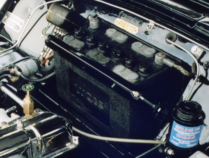

In 2003 on the way to TRA in Auburn Indiana, I picked up my third "LUCAS" battery from the Antique Battery Co in Hudson Ohio. I had pre-arranged that it be full of acid and fully charged. All 3 were Group 27 batteries where I specified that the tar top should be their newer polyvinyl something and that the lead cell connectors be visible. Also I wanted the positive post to be at the rear right hand side as you look at the battery - for positive ground.
I got 5 years from each of the first two batteries and am now in my 7th year with this latest one. My records indicate that I have driven 32,000 miles on this latest battery and it always starts in the first millisecond as I push the starter button.
