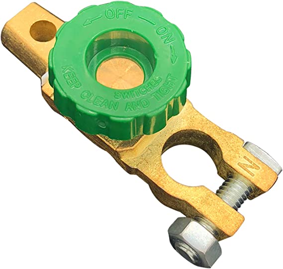

Other than an electric clock running 24/7? Until you find the problem, put on a battery disconnect. Something like:

yes all my MGs have that. but the issue with the XJ is that the battery is in the trunk and the key has a chip that needs electricity
