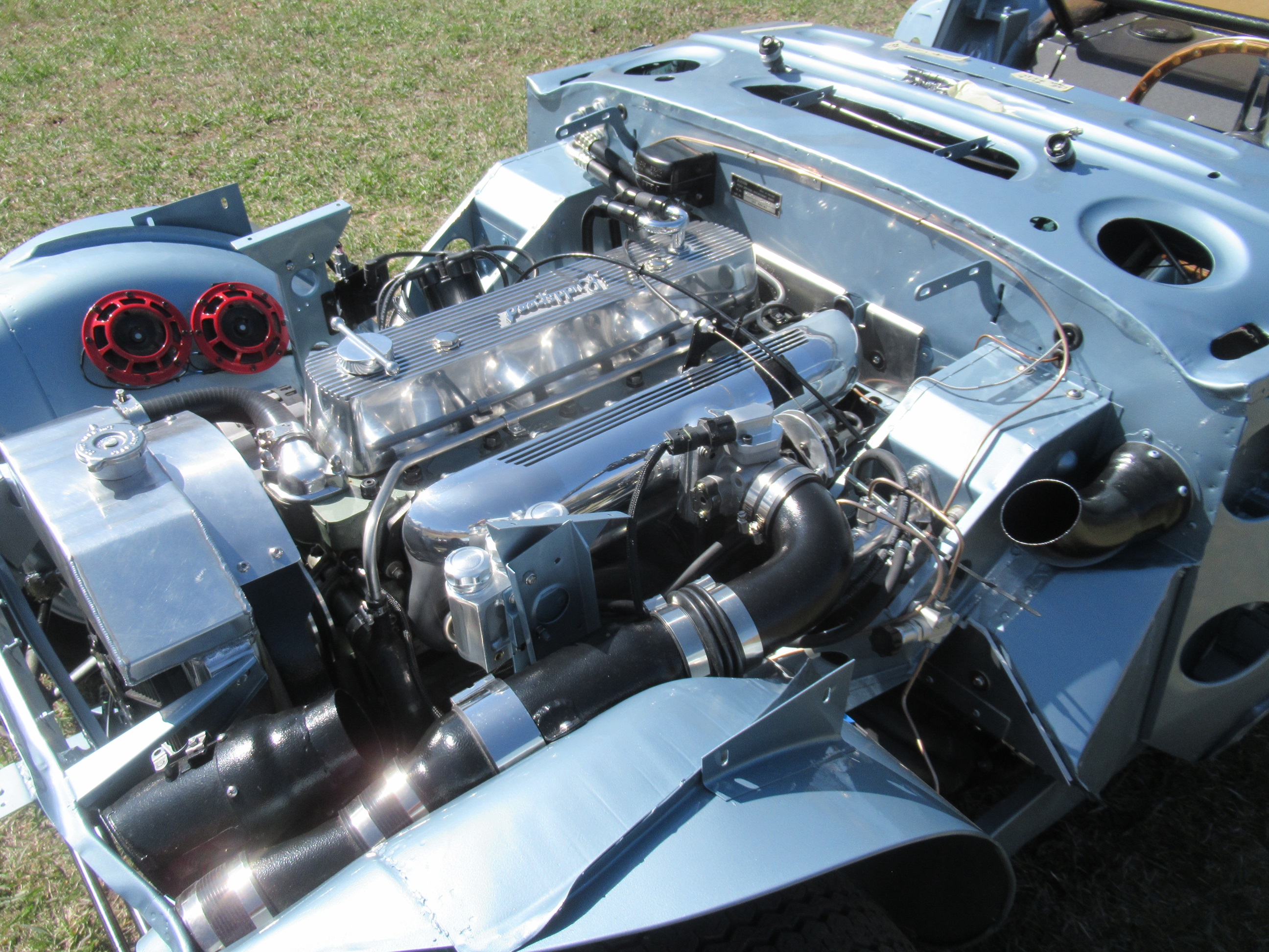

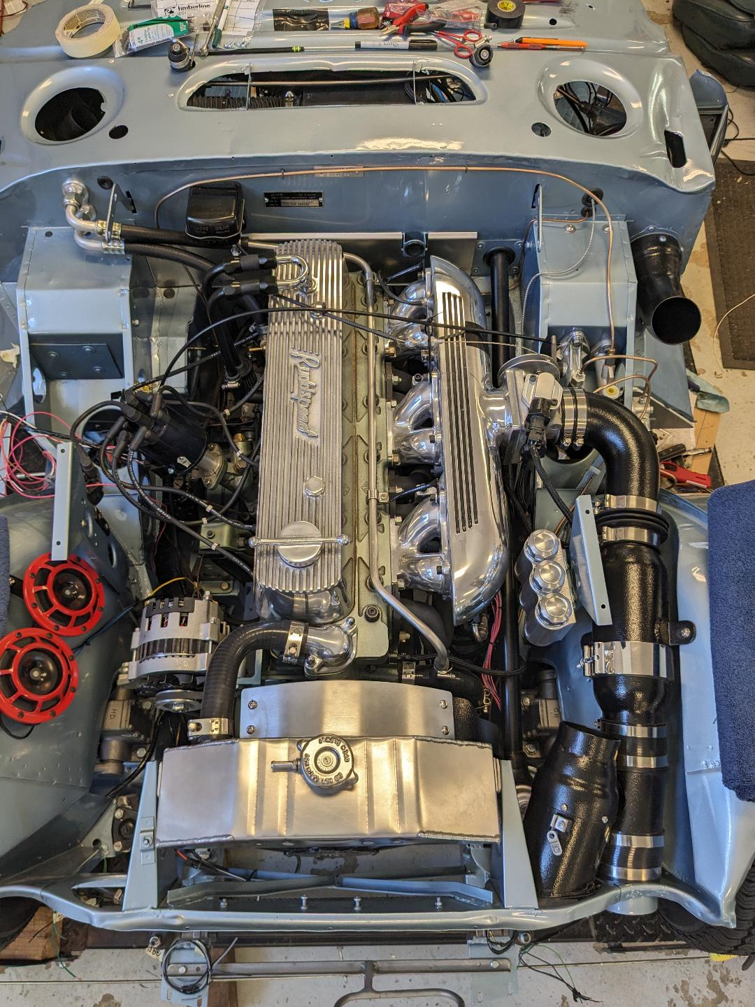

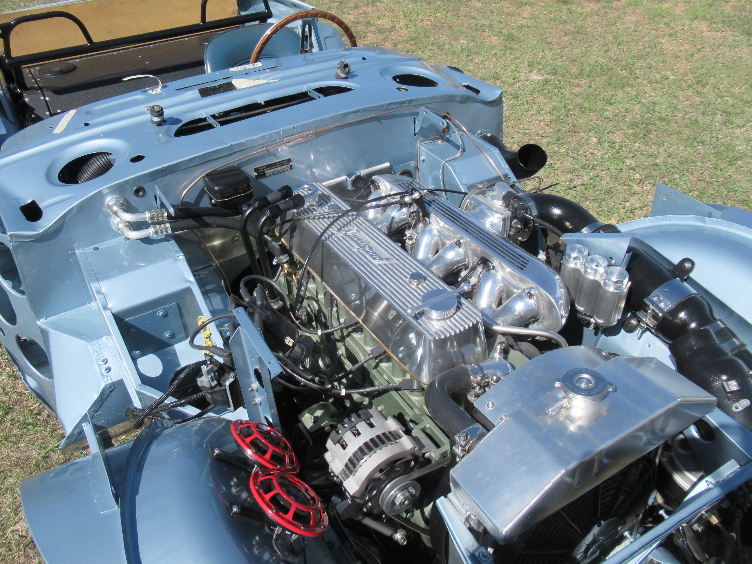

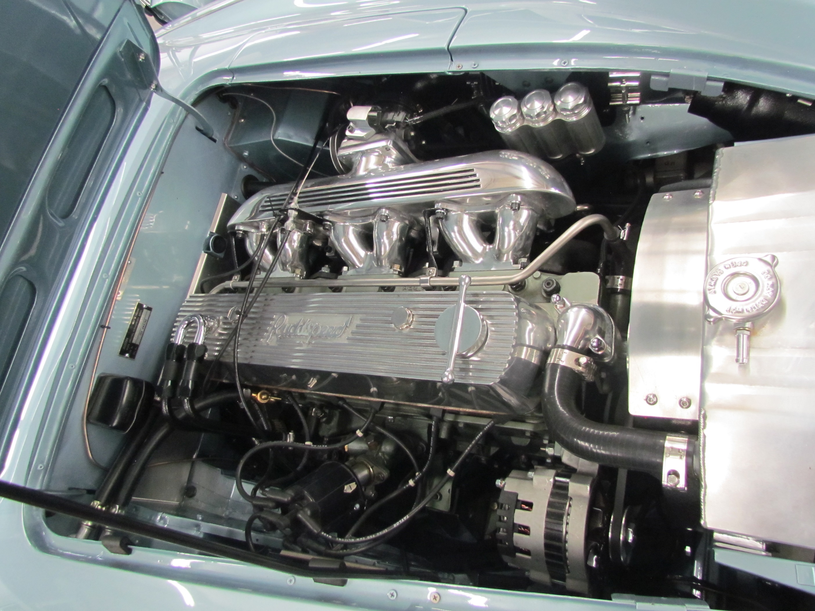

Well it's finally coming together! After a bit of a false start, yesterday the engine came to life in its new home with all new wiring. A multi-year effort that finally has it's new heart running, albeit still in a bare chassis. The engine is a "performance street build" with head by Hap Waldrop in S.C., cam by Dema Elgin, rocker arm assembly by Gary Patrick, a few DWM items, MegaSquirt computer and custom injection, plus lots of detail stuff. The engine has about 10-12 hours run time on an engine stand before being reintroduced to the chassis.
The wiring was another 6-week effort for all the new electronics.
I'm ecstatic to finally have the engine and chassis back together and running!! It's been a long time coming!

... plus lots of detail stuff.
Just from what I can see in that one (1) picture, looks like that's going to be the first BILLION Dollar Healey!
I'm a detail person, and I think I could pour over the details on your build for days :cheers:
I am curious though, is there a particular reason that you stuck with a conventional distributor, versus a stand alone (crank-trigger, 1 coil per plug) type?
Beautiful work, can't wait to see the rest of it__even if you make the rest of us look like total slackers ;)

Randy, good question... and I do have an answer ... but not sure it would be satisfactory. The distributor is not just an upgraded Lucas unit, it is a all electronic GM High Energy (HEI) unit that was machined to fit. It has a couple nice features for my build, 1) is has built in plugs that can be wired into the ECU (they are on the back lower portion of the distributor and not really noticeable from the top view), 2) while it is a HEI GM unit, it is the early version so the coil pack can be mounted away distributor leaving the distributor to look more old school, 3) it is electronic and has connection to my electronic tach (face of tach is original) and 4) last but not least, I had one just like this on my last build and liked it so it was a proven component for me... and I was reengineer so much it seemed a "safe" choice. Oh, and I kinda like that it appears old school. All that said, yes it could be argued that a crank-trigger arrangement would have been current engineering. .... maybe next time?

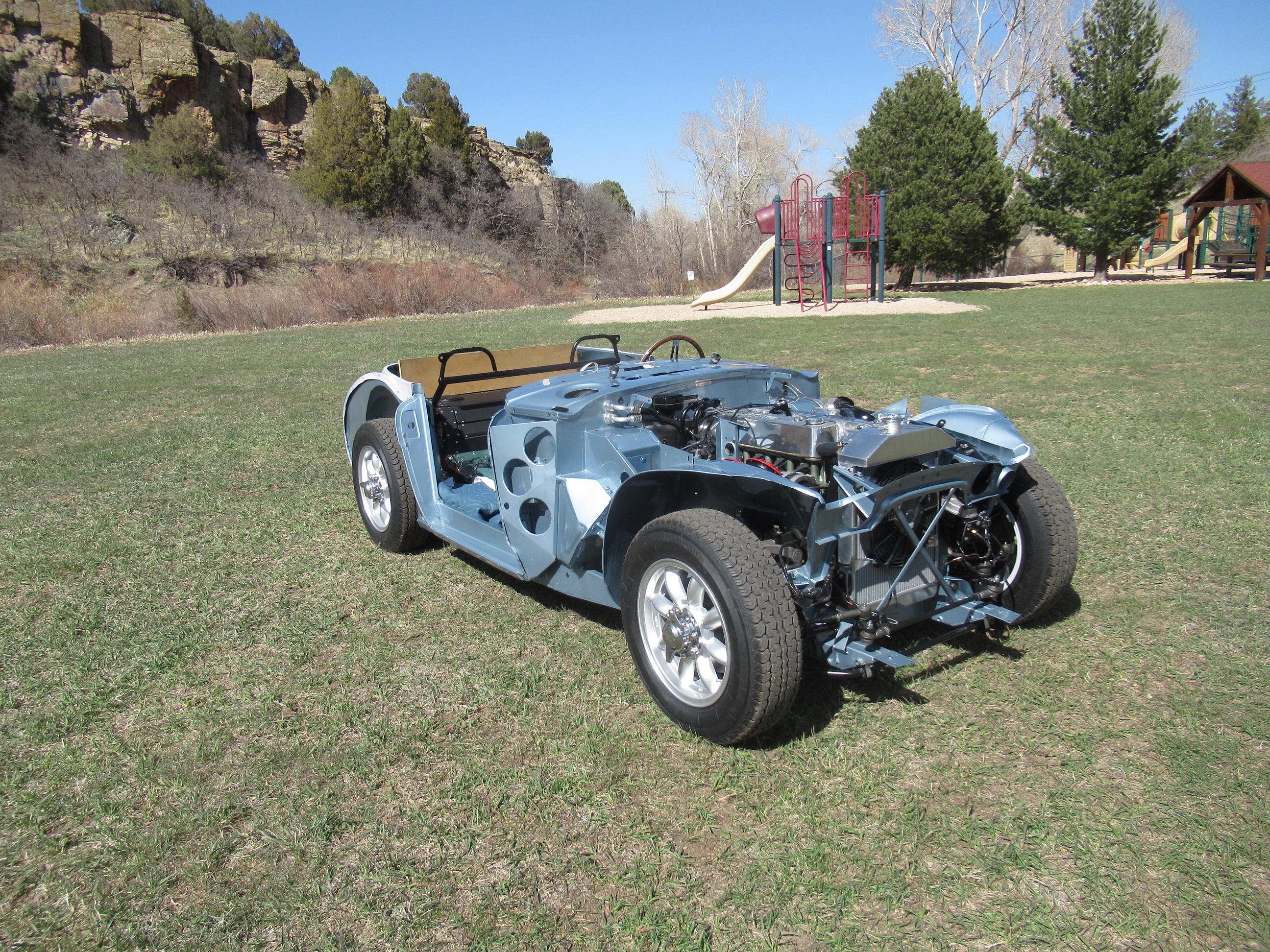

I got my naked Healey out in the park today. This weekend I start getting it clothed! Panels are already painted on the inside. It has a date with the painter in about 3 weeks to get final exterior paint.
Cheers,
Steve
