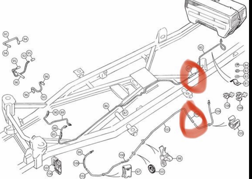

Just check the flex hoses in the fuel line toward the rear.
part 85 or 100
They can swell and reduce flow esp if bio fuel is high content.
I had thus on my 3a would be ok at idle revving but would die on a run.
it’s a dollar fix even if it’s something else.

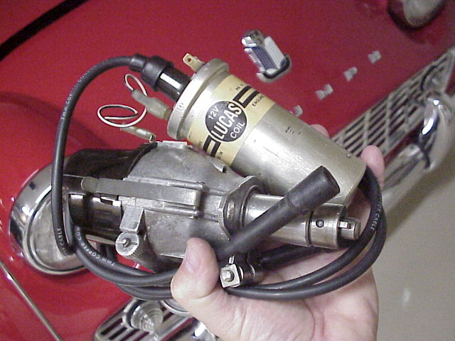

The stock ignition system is so basic you can hold it all in one hand - takes so little space I always carry a spare of everything and sort out any problem when I get home:
