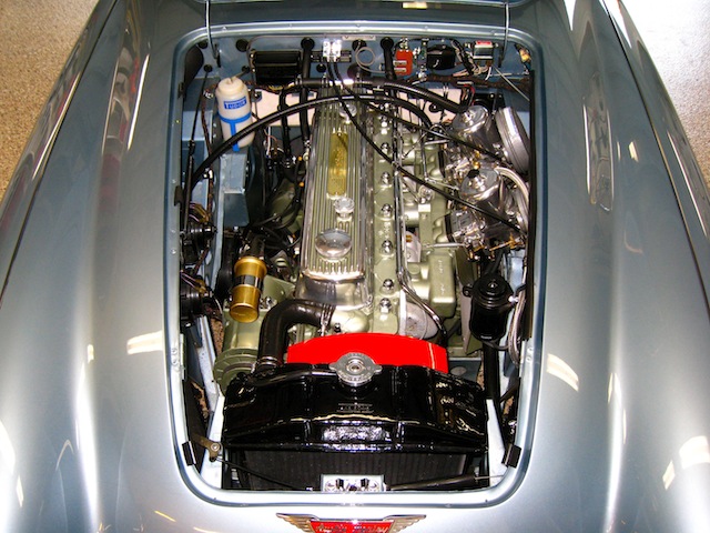

1) Is there a piece of trunk liner missing on my car? Or is that rear panel supposed to be uncovered?
2) Is the metal top frame the right color?
3) All the small bits in my engine compartment are bare metal and getting surface rust (e.g. screws, brackets, accelerator linkage). Should these be painted, and if so, color?
4) Somebody put 8mm gray plug wires on this 3000. What are the proper plug wires and spark plug connectors?
I think that is it for now. Just want to say thanks for bearing with me. I guess I could have found a book for this info, but it is more fun, and probably more accurate, to ask you all.
If you see anything else in the photos that I should tend to, please sing out, it won't hurt my feelings. I just want this 3000 to be as authentic as it can be.
Best regards, Jeff

Jeff, most all of the hardware that is rusting underhood should be white zinc plated to be authentic. You can buy a kit to do this from Caswell Plating (find on internet). You need to buy the Anderson/Moment book on Healeys! The engine was painted as a complete assembley when new so most of the pieces directly attached to it were also green. There is a filler piece missing in your boot liner , it tucks behind the support for the boot striker. The hood frame looks fine. You're missing bonnet buffer pads and weatherstrip which will support your bonnet properly and keep it from chipping the shroud paint. It looks like a pretty decent car and I'm sure nobody here feels bugged ! The better you know your car the better service it will give you. Kevin

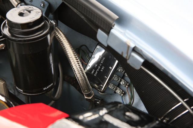

Jeff, That is what car forums are all about! You take excellent pictures an I enjoy seeing the details. The one item that jumps out to me as being out of place is the braided fuel line.
re: #4) The correct plug wires are 7mm stranded copper wire core with a right-angle plastic caps with 'Lucas' embossing on the end (Moss Motors and other suppliers have them). If you have an original-style distributor cap with the 'puncture-style' terminals and modern, spiral-wound carbon-core plug wires you will likely experience ignition problems sooner or later (an occasional miss on acceleration may be the first symptom).
There should also be rubber O-rings corralling the #1-#2 and #5-#6 plug wires together.

The braided fuel lines look to be as correct as you'll find, even the clamps look right. The fuel lines would each have had yellow ID bands on them, "Smiths Petroflex" if I remember. Looking the the underhood picture and blowing it up I can see a lot of effort to get it close. Leave it to the British to put a Lucas electrical horn directly underneath an SU carb. If I'm not mistaken this car is early enough that it still uses the 100-6 wiring diagragm in the shop manual.

I don't see the Cooper decals on the air filters. Maybe they weren't added to the BJ7 like they were on my BT7.

Lovely car Jeff, how authentic your car is can't necessarily be answered looking at photos, it all depends on what level of detail you want to go to. You could start down the road of making sure that all of the Lucas dated components have the correct date codes on them to match the build of your car, etc... One thing I notice that's not 100% right is the battery isolating switch, the correct original switch has a shorter knob, whereas all later replacements are longer.

I noticed the copper water pipe is not painted. It should be the same color green as the engine. As mentioned, some of the parts on the engine were painted engine green while on the engine, just like the short rubber hose, to the left of the T tube at the back of the valve cover, and the J shaped rubber tube at the bottom of that pipe.
For safety, put an inline fuse close to the license plate lamp.

For bare metal or the zinc plated look for Race Glaze Jet laq non-paint laquer
Its a sort of clear coat but heat resistant
I have used it on the copper pump of my high presure cleaner, works great
