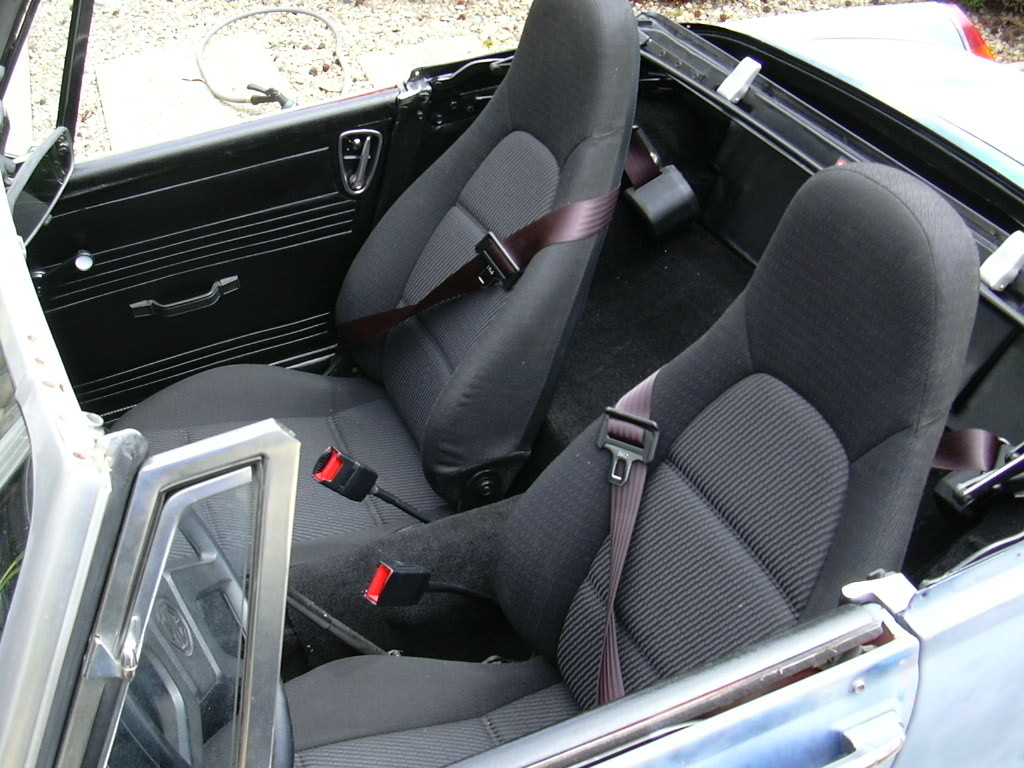

Slightly off topic, but if you don't have to keep original seats, try a pair of 2000 Miata seats. Around $150 a pair used, and easy mod. See attached.
