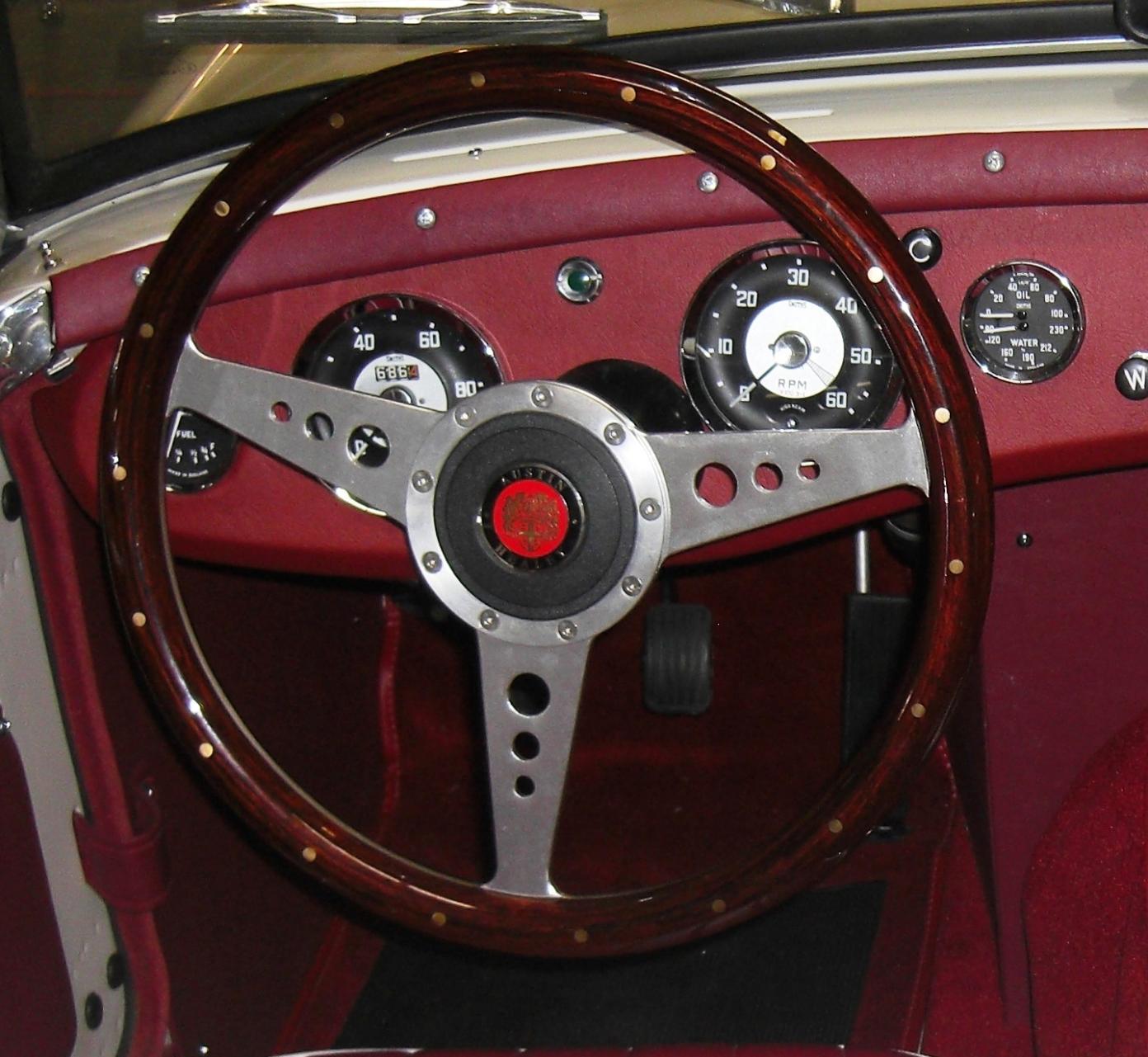

Here is my Tourist Trophy steering wheel on my old BE. I had a shift knob made to match.steering wheel.jpg
Scott in CA
Scott, other pics at the beginning show wheel oriented 180 degrees different. Any issue with reading gauges ?
I don't have a problem reading the gauges except for the gas gauge slightly, but how often do you need to check your gas gauge. PS its not and old BE it is a new BE, at least for me.
