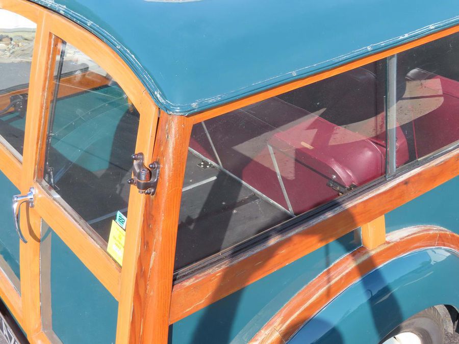

Now that my Morris Minor Traveller has arrived (after six weeks of delays caused by winter storms ...), I'm wondering how to protect the old wood frame. The wood is solid, but the original finish is cracking and peeling/flaking off.
I can sand off the loose spots, but don't know what to use for the final finish. In the UK, Traveller owners use "Burgess Marine Wood Sealer" - but I don't know the USA equivalent.

I'd say good old fashioned marine spar varnish.

Thanks Mickey. One thing I've learned from other Morris owners - never use varnish, as it seals the wood and prevents "breathing". I don't understand that concept at all, but that's what they're telling me. They use something called Burgess Hydrosol Marine Wood Sealer, which isn't available in USA.
Mickey Richaud
Then, I'd imagine the second item I listed would fill the bill. Seems like you'd have to re-apply from time to time.

Thanks all. With advice from other MM owners, I'm going with scraping the surface (not sanding), then coating with tung oil, or maybe a marine "breathing" seal. Seems to be a recommended process.
The car will be kept in the garage - never (I hope!) seeing moisture.
