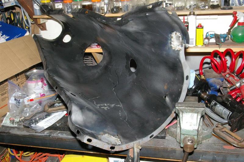

Can someone provide a photo of an unmodified TR3A transmission tunnel on the handbrake side? Mine has this crude patch where the handbrake and speedometer cable meet.
It also has four carpet snap holes on the driver's side and three holes on the handbrake side. Believe there should only be four total? Thanks - Walter

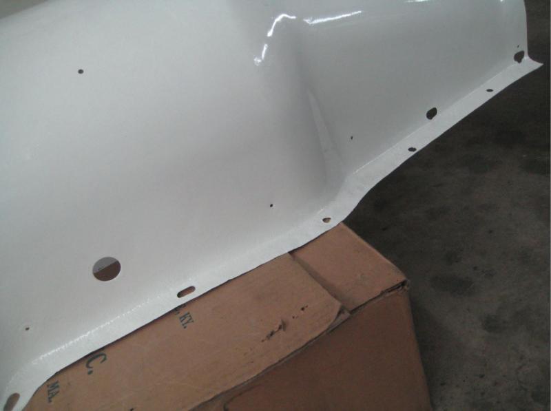

Hi Walter...
I have a couple sitting in the garage...I'm at work now but if someone doesn't post a pic before I get home, I will post a couple for you.
Cheers
Tush

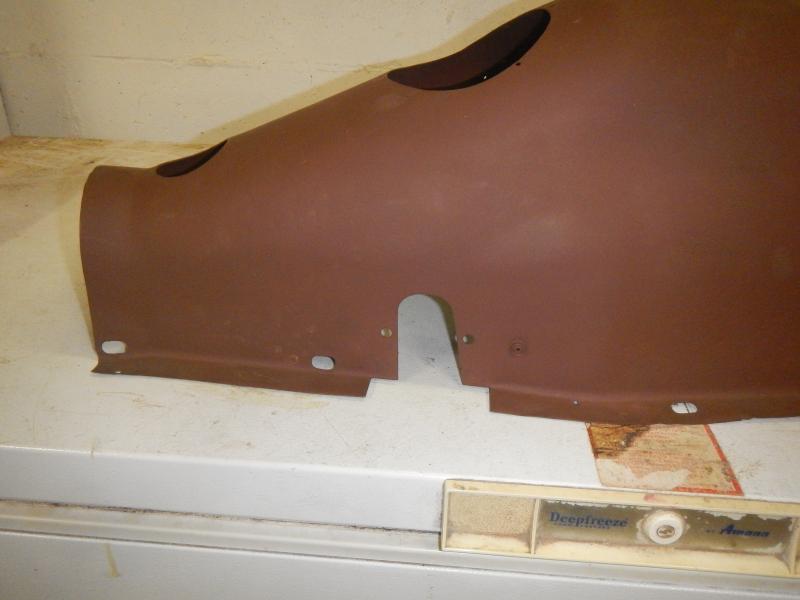

mgedit
This is not a great picture, but only one I can find. My car is very early TR3, but suspect tunnel is same. Sure Tush will be able to get better pictures for you.
Cheers, Mike

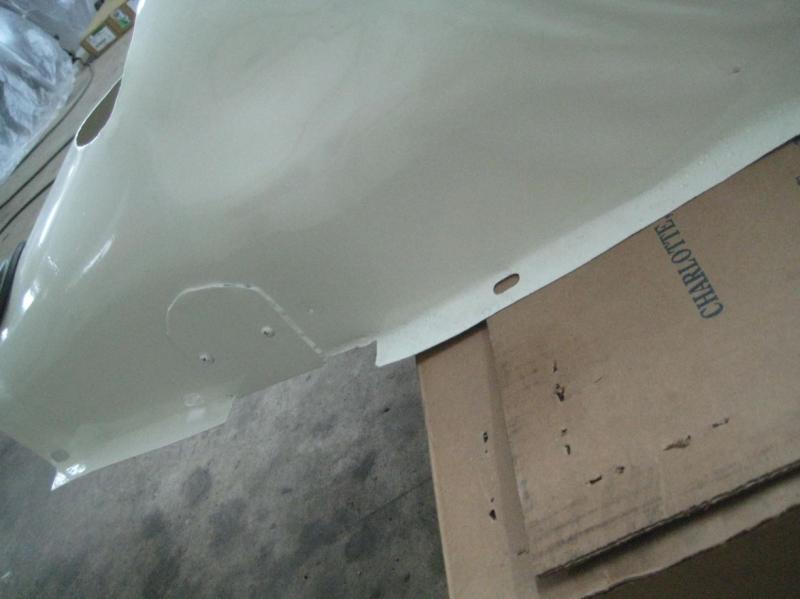

Hello Walter
As far as I know mine is unmodified. It has 2 snaps on the passenger side and 1 snap + 1 hole for a snap on the deivers side.
David
M_Pied_Lourd
Good Pic David.
Cheers
Tush
charleyf
The hole in the side of the tranny cover is for the speedometer cable on the overdrive trannys. The boot that is sold is for covering this over plus providing a boot for the base of the parking brake.

Thanks to all of you guys. So that nasty looking homemade plate covering the handbrake/OD speedo cable area is just that, and shouldn't be there. I have the TRF handbrake boot kit that would mount there. I'm guessing extra holes were added for carpet snaps at the bottom on both sides, although they all look original; three on the passenger side and four on the driver's side.

I hadn't thought about that and it makes perfect sense. Unfortunately, I didn't pull the cover for this restoration but want to say that it did not have the boot kit - at least the rubber was gone - when I parked it in '98, but would have had originally... and of course my original configuration was without OD.
Wonder if that crude plate covering the hole could be from the factory. It has dissimilar Philips screws, and Philips were less common on these cars... who knows!

I think the Phillips screws are a sure sign that it is not factory. I think in a previous post we all decided there are only a couple Phillips screws on the entire car. They were extremely rare.
