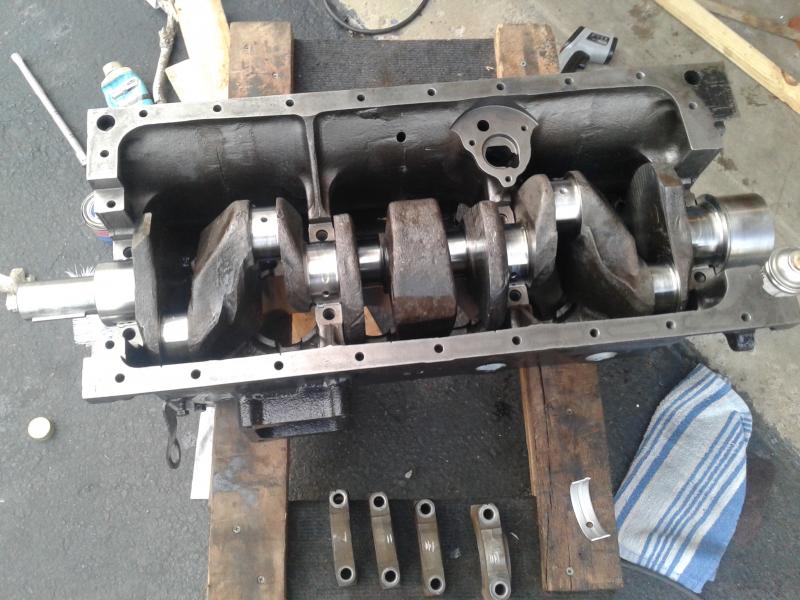

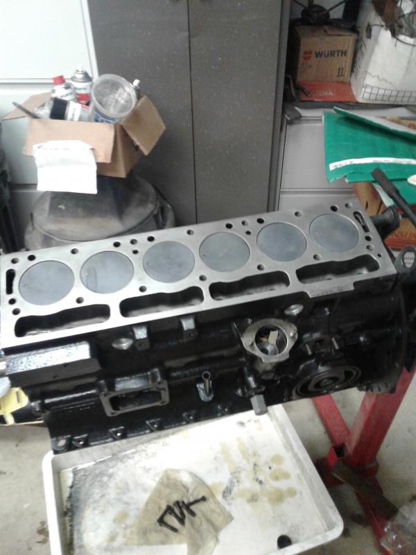

Is there a way to check if the engine is too tight. Honed the cylinders with a nice cross hatch, new rings also used a ceramic coat on the pistons for lubricity. Pistons went up and down nicely with out rings. Crank installed with standard thrust bearings. Crank turned nicely by hand and 6k on crank end play. So I installed the rings pistons and rods. The machinist that helped me checked the ring gap and said it was fine. It's been a long time since I did an engine rebuild but it seems like it's a bit too tight. Takes a bit of effort to turn and I can hear the rings scraping.
