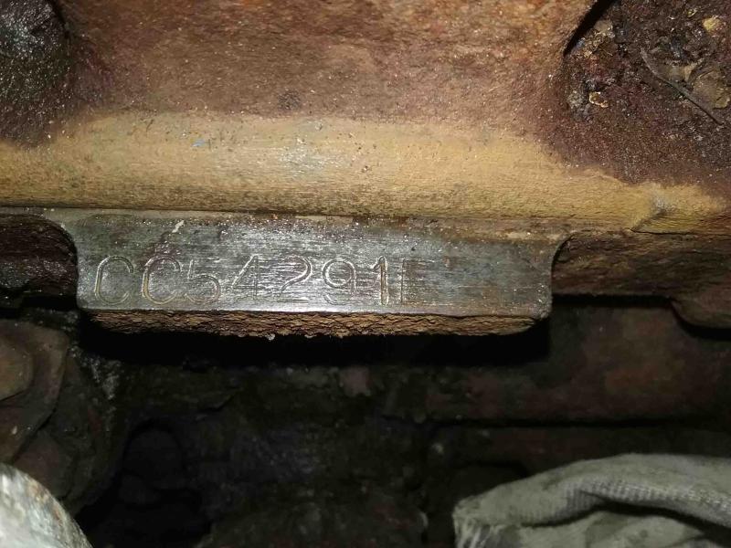

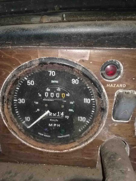

Picking up a parts car on saturday for my 69 TR6 project. Found a 1970 TR6 but came from Europe. Not to many salvageable body parts but has A type overdrive. Was hoping for PI but lucked out there. Anyway my question is is there any way to determine if this is a Euro speck engine. Hotter cam, higher rocker ratio and higher compression?
Thinking if I can use the cam and higher compression head and rockers to get a cheap upgrade in engine performance. Oh ya speedo is in kilometers.
TR3driver
Great Pumpkin - R.I.P
IIRC, the early PI engines had a CP prefix on the serial number, instead of CC for carb models.
Rockers are the same. But if the PI has been replaced with carbs, I wonder if they might have swapped head & cam too?
Tybalt
As Randall said, look at the engine number. If it is from the "CC" series then it is an early carb engine while a "CP" would be an early PI engine. Also take a look at the valve springs as quick and dirty but not entirely accurate indicator. The "CC" engines used a single spring while most of the "CP" engines used dual springs. Some of the late "CP" series used a different rate single spring than the "CC" engines but as near as I can tell those were limited to some of the 1972 model year cars. The other variable on that is that someone may have fitted their "CC" engine with dual springs. I have dual springs on a "CC" engine that have the spring rates and subsequent seat pressure matched to the camshaft I am using.

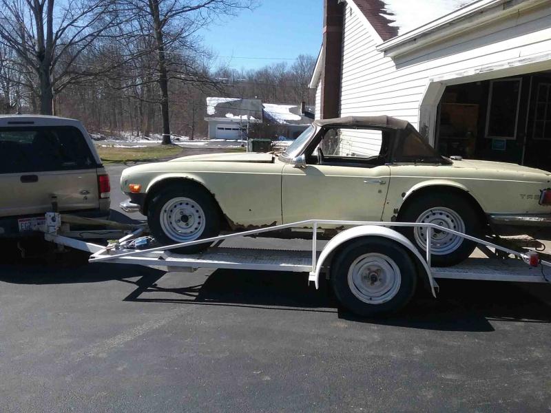

The guy I bought it from purchased it from the original owner who drove it in Europe and when he moved back to the US he had it shipped here. Unfortunately the paper work was tremendous and never did anything with it but put it in a dirt floor barn for decades. This guy did all the foot work and got a title then discovered it was too far go for him to redo. That's where I come in.

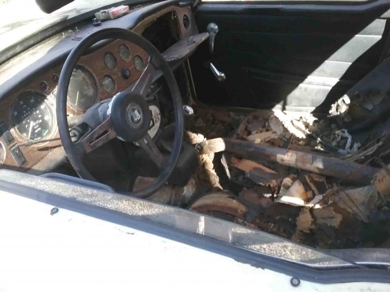

That's what I meant about the cranks Randy. Car is here safely. What a rats nest! Sucked more foam, raise-nets, skeletons and a few good surprises too. Like a box of Cracker Jacks. I'm not believing this story about a Euro car. Speedo looks like MPH not kilometers . Engine # is CC and single valve springs. Although there is a E at the end of the engine number. Don't know what that means. Had to throw away the air cleaner housing. Full of mice junk and rotted away from holding the moisture. Carbs were full too.

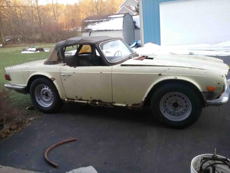

Whats amazing is someone started on this car as a project. Did the wheels, put clean anti freeze in the engine. There is no driver side or trunk floor. Every fender has rot through some wear. The battery box is rotted through the fire wall along with other places. I guess anything can be fix but what were they thinking.
Got the carbs off, radiator and front bumper came off in a snap. How do you get the rear bumper off? Every bolt just spins and there doesn't seem to be a nut behind the brackets. Don't know how you would even get a wrench in there if there was.
