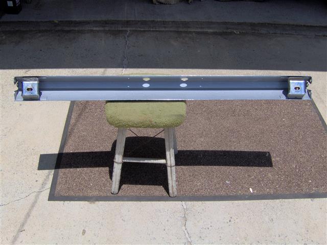

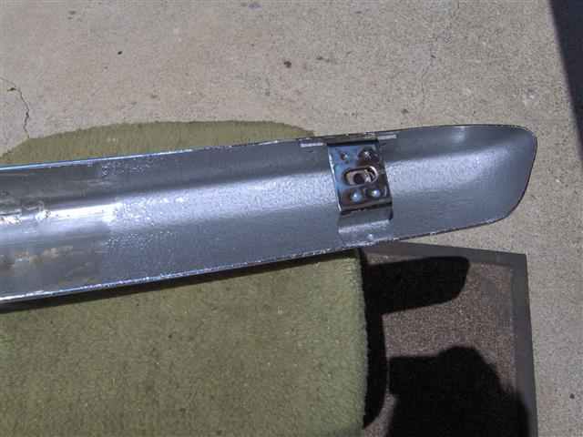

Got, the two nuts for the back section are knurled pressed fit. Once they start turning you'll have to get a wrench in there or just cut the head off the bolt. The two side pieces have a captive square nut in a cage behind that bracket. Once 'they' start turning, you will have too get creative.
Sorry that the best I can do....
That's Rust-Oleum Hammered paint I used to cover the backside after I had them chromed.
