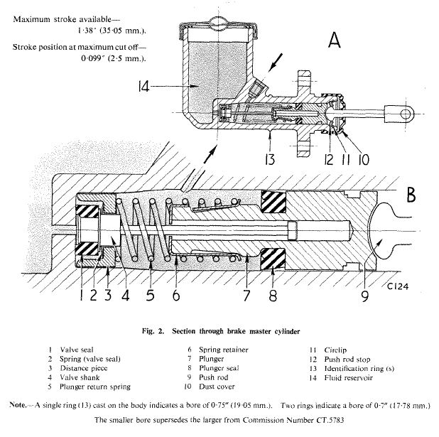

Since there's no leakage, my guess is that you have fluid seeping back through the seal into the reservoir. Part 1 in the figure below. It's a pretty common problem, and the solution is to get a rebuild kit for the master cylinder and rebuild its internals. (The figure is for the TR4 MC; I assume the TR3 works the same way.)
When you remove the MC, look down into it and see if there is a problem with the seat that the seal presses against. If so, it's best just to replace the cylinder.
