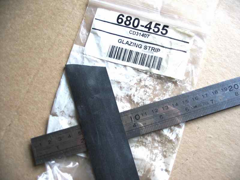

Don Elliott
And use the rubber glazing strip (roll) like I used. Got mine from Moss. It's the right texture, the right width and and most important - the right thickness.
