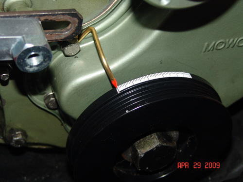

Following Hap's post, here is how my timing pointer is set up on my MGB. Different engine but same idea. I used a MSD Timing sticker (PN 8985)I bought from Jegs for a 5.25" pulley that came with my Supercharger. With my B, Iinitally set timing around 15* BTDC and then at 3500 RPM around 32* or until it pings.
