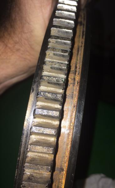

Here's a pic of my ring gear showing how much it moved....

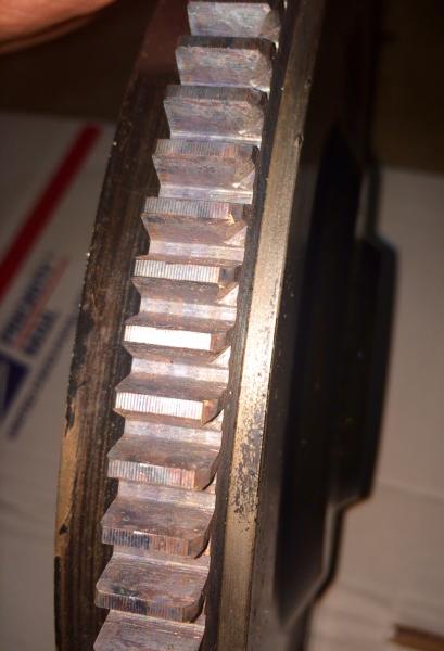

Here's a pic of the new ring gear after installing on the flywheel.
B

Bingo! I looked in the hole where the starter bolts on and sure enough, the ring gear has moved about 1/4". That explains why the starter gear wouldn't mesh with the ring gear. Thanks very much. You solved the mystery. Bob
