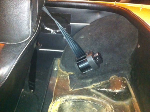

Bit of progress tonight, got the new seat belts installed (retractable ones from Moss). Never liked the static belts I had before, just didn't really work like I had hoped. A small thing, but progress nonetheless.
