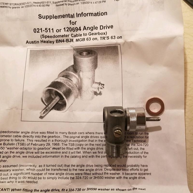

Do you have the angle drive on the OD box? Also the washer that goes between the angle drive and OD?

Thanks Randall I will get a look in the morning. No David, I used the 96 inch cable and used a big loop and come through the shifting tunnel at the rubber boot bump. I think that is what the bump in the rubber boot is for by the E brake, but I have never installed an OD before.

So I do not need to use the angle drive. I did get the extra long cable. I do see on the documentation where it says TR's 63 on.

I checked, according to the factory catalogs, the angle drive wasn't used on TR4, introduced on TR4A (when they moved the handbrake location and eliminated the holes where the old cable ran). On the 4A with the angle drive, the longer cable is not required.

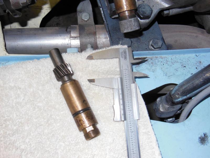

I dug out a non-OD setup and they measure and look the same as OD—But the one in the car will not give any. There is a way to remove the inner brass section from the outer with flat side on the outer edge, but again I am not sure that will help any. Perhaps some kind of pulling tool would fit in there. I put a small amount of WD in the hole where the bolt came out on the top of case and I am waiting for that to work. Plus I was able to get some leverage by using the aluminum end piece and pry against that-- but no joy. There must be another way with some kind of specialty tool. Where is Geo he has all the cool pics of cool tools. I have been tapping lightly with some wood trying to cause some vibration. I hope one of those rebuilder guys might have a gear he would give up, but heck it might worse inside. I guess I should have tried to rebuild the OD in the beginning, but I was overwhelmed with learning body work

Well I killed the brass end on it, but I pray a non-OD is the same. My thoughts are aluminum oxidized to brass. Anyways I do have the bushing turning left to right about a ÂĽ turn, but it will not head out of the casing. Plus there is no way to get any oil between the case and the bushing and the bushing is a few inches long into the case. Any ideas out there? I am afraid to heat the brass because I do not know if it would do more harm than good. I guess keep trying to work it out left to right and cry for help.

That is common for the assembly to get stuck. If you have already damaged it, then just use big vice grips and twist it out. It does have a lock bolt in the tranny, so make sure that is removed first, or it’ll never come out. Don’t feel bad...some of those are so stuck they will never come out without damaging them. I am sure it is galvanic action with the aluminum, as you suggested.
There is an inner and outer sleeve to the brass assembly. If you look closely, there is a pin drilled and driven through to hold the 2 together, though. Before you can separate them, the pin must be drilled or it will damage the soft brass threads. Inside there is a seal that you can replace, if you want to.
I find it interesting that the assembly would strip. It is normally pretty stout.
You are in luck, in that the assembly is common throughout the TR2/3 range of trannies, with and w/o the OD.

Thanks John I truly appreciate that a lot. The square drive at the end was damaged and broken off at the very end--- somehow, and I believe it was blown out from an old broken cable, but I do not know. That is what accelerated my efforts to remove the assembly. I used a slim 5/8 wrench on the end bushings and separated the two brass pieces at the end and saw the damage to the tip-- then I put the aluminum end on and pinched that between the brass and 5/8 wrench then smacked it with a big screw driver down low, but it cracked the brass at the end.
Anyways yes I have gone to vise grips and got it to turn some. Probably 5 to 10 years ago, I would have twisted and turned with down pressure and get out more easily. Now I am going to use more leverage. One problem I see is because OD speedo assembly points down with really no way to get oil in there except if I had it apart-- maybe, but heck it is so oxidized and tight no oil might ever get in. Would you put heat to the brass if it was trashed or stay with muscling it out?
