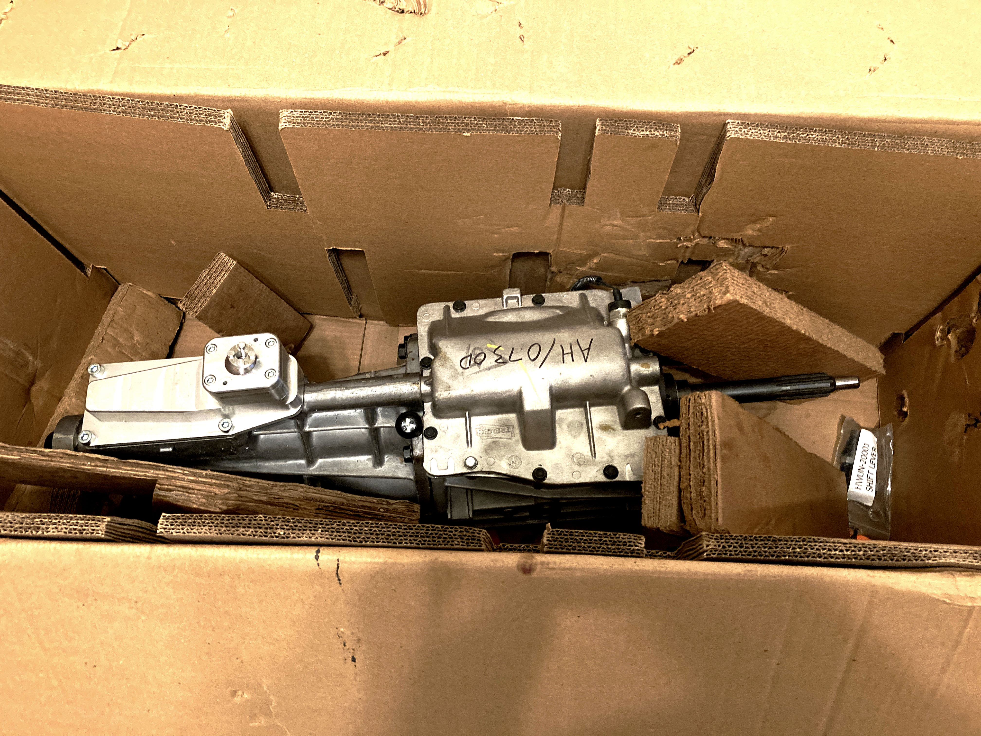

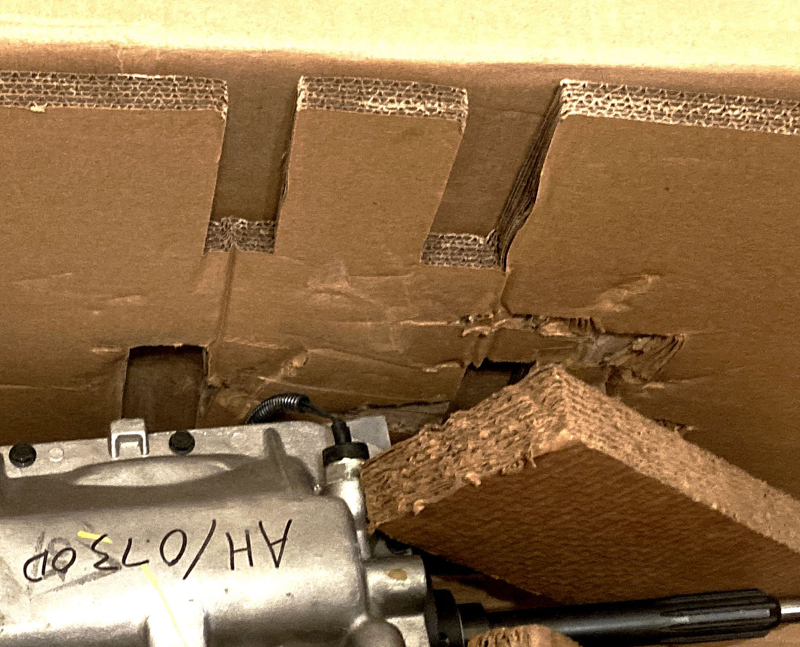

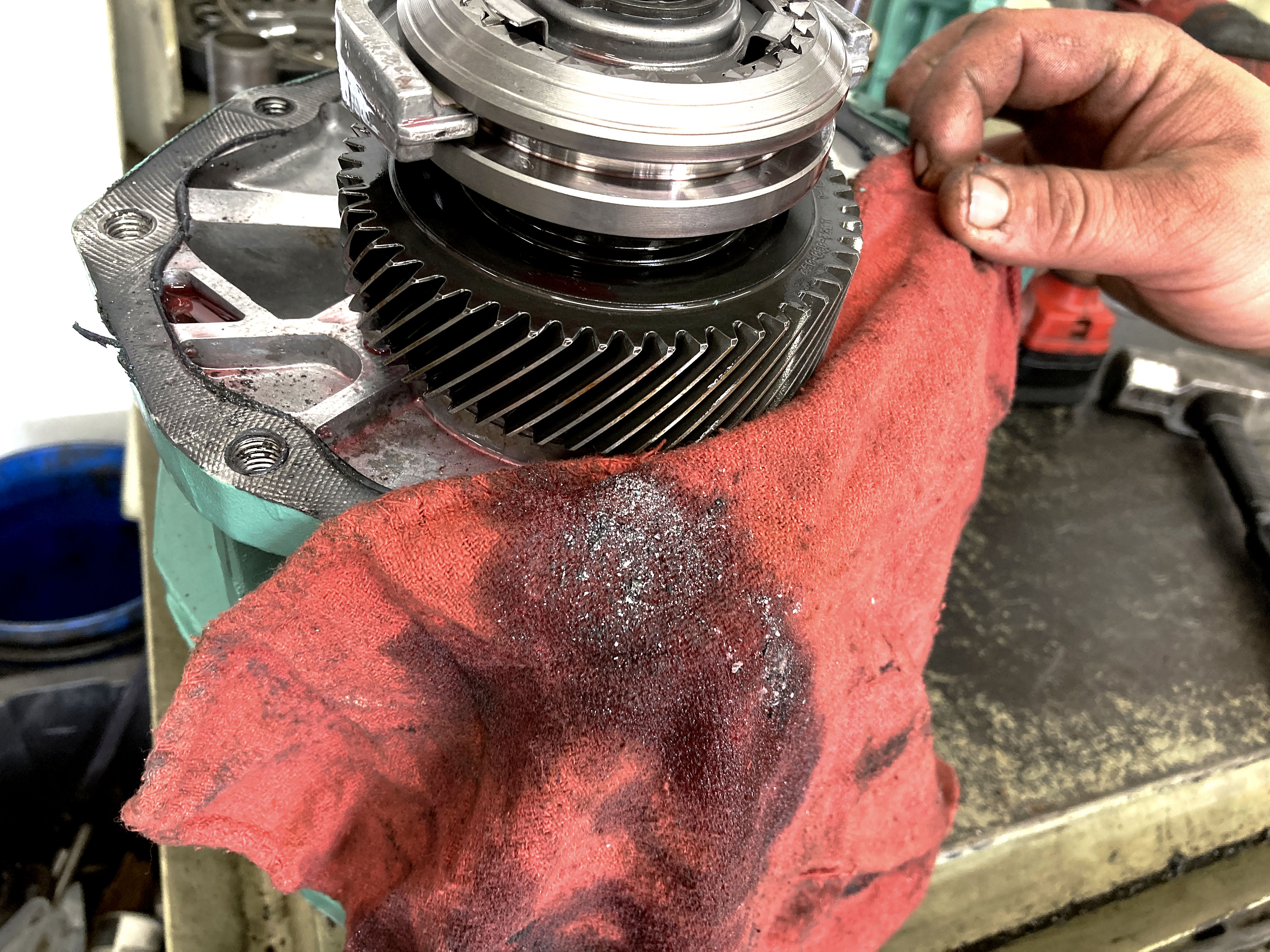

Having purchased a T-5 from Driven Man, I wish I had absolutely made every effort required to find a Toyota transmission and buy one of Pete's kits. Pete can sometimes help you find a good transmission.
Regards, Bill
