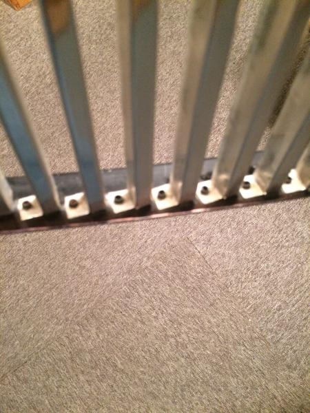

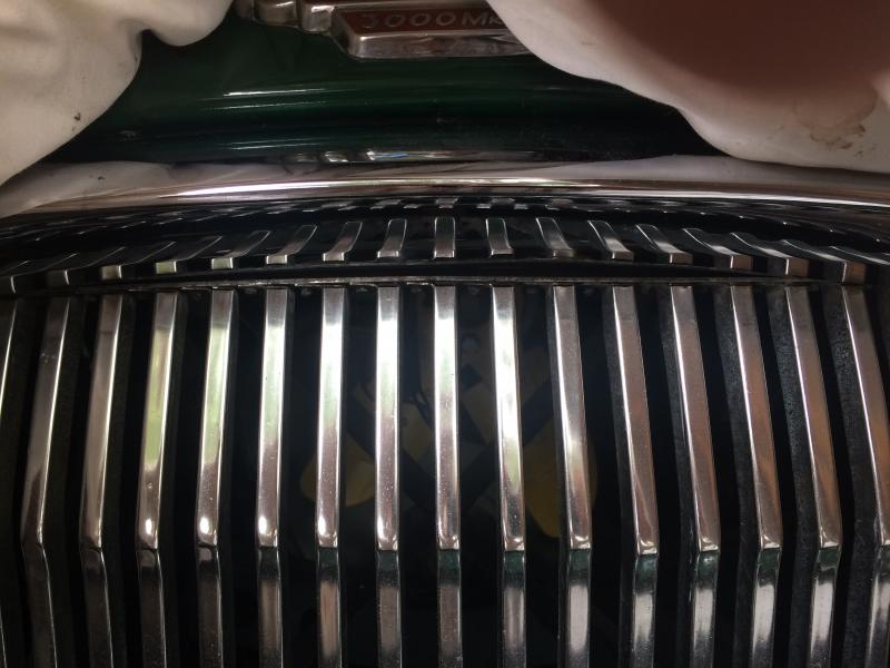

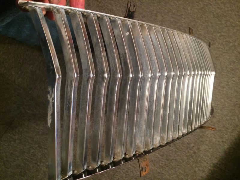

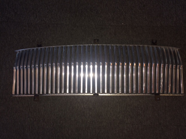

Hello Forum,
I have finally decided to refurbish my BJ8 Grille and Surround. Since I've pulled out my radiator and fan blades for refurbishment, figured it was a good time to tackle the grille assembly since I now have better access to all those 6 mounting points supporting the grille and surround to the shroud.
The grille and surround are now out, along with the splash guards and deflector shields. There are a number of things I'm doing at the moment which include:
  1. Better alignment of some of the grille's teeth. That is, where the imaginary mid-line runs horizontally across the grille. Existing condition not bad, but I do notice slight unevenness or waviness at the extreme ends when viewing the grille from an angle. I will only apply a bit of physical pressure in spots to the top and bottom mounting rails to straighten, since they too, are a little wavy, which will hopefully be enough in straightening some, if not all, that imaginary line. I realize I may not achieve total perfection but an improvement is hopeful. All the vertical teeth are in excellent enough alignment to each other. No further improvement necessary there;
  2. Remove a small number of dings to a half dozen teeth. No major problems anticipated there;
  3. Cleaning/restoration of aluminum surfaces to front of all teeth and their sides (One of my questions is noted below);
  4. The existing chrome eyebrow is now overlapping the surround. I plan to correct it by placing the eyebrow under the surround. Seems to be the accepted norm, though I must admit, I like the eyebrow over, more than under;
  5. Spray paint the inner portion of the surround a matt finish (silver ok?), as came out of the factory. Surround is presently left completely finished in chrome.
Other thoughts I have and hopefully some light from the Forum can be shared, especially:
  1. Item #4 above. Can anyone recommend what to use to remove subtle pitting of the front aluminum teeth and removal of the oxidation to their sides? See first photo. Just curious. I've tried different approaches and although the overall appearance has improved, I’m seeking a more nicely restored look, if possible. Should I use a matt silver spray paint on the sides only (leaving the front teeth finish alone, as is) and be done with it?
  2. In the third photo shown, please notice how the top mounting rail sits below the surround's underside, leaving a gap by approximately a ¼ inch. Question: There are 4 slip type mounting points and 2 remaining holed types which secure the grille to the shroud. I was thinking of elongating all the mounting point openings, so as to allow to raise the grille a bit higher. At least another 1/8”, if possible. Good idea?
  3. In the middle photo shown, I've read in some older posts how the bottom rivets securing the grille's teeth were actually sprayed a black finish to hide the rivets. Is this true? Any thoughts on how to finish that area or was that how it left the factory?
Thank you for any input offered. Much appreciated!
Paul

Healey Nut

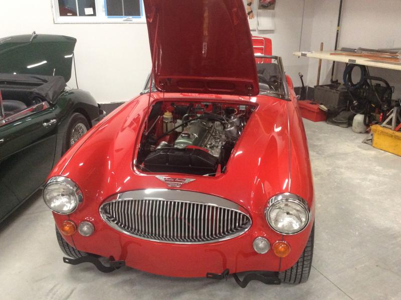

When I did mine I had everything rechromed and the damaged ares where the brackets are welded to the mouthpiece repaired . I didnt bother with the matt finish line in the bottom as Im not a purist . As far as I know it wasnt spray painted but sandblasted after chroming to dull the finish (Im sure the purists will correct me on that) As for the grill teeth I just did some straightening knocked out the worst dents then sandblasted the assembly to etch the surface and spray painted the whole teeth assembly silver .I used that dupli color chrome paint .....I think
All looks great to me , I have had lots of purists look at the car and never ask me “is that grill painted”

pkmh
pkmh
Keoke,
Appreciate your opinion but skipping the pro approach for now. It is better than it was before so I'm happy!

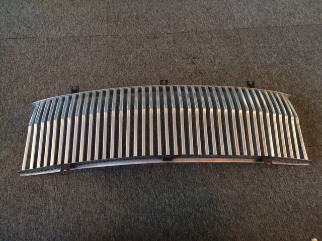

Healey Rick,
Your grille looks good from where I'm standing.
I just finished refurbishing my grille and am satisfied with my results. Got all the annoying dings out, cleaned and buffed the fronts and sides of the teeth, aligned better that horizontal mid line, even tapped out one tooth from behind to create an more perfect imagery arc line and finished with elongating the mounting holes slightly. See pics:
Hopefully, remounting the grille with even become a more perfect fit after sorting it all out.
The surround is now next.
Thank you so far.
Paul

I have tried everything to get that mat finish it left the factory with. Etching primer,all types of spray on paint. Nothing holds up. Scratches off easily. Finally just left the chrome.

Think you meant Healey Nut. Mine was in pretty good shape with a couple of dings. I replaced those "teeth" from ones from Healey Surgeons. Looks good enough for a Nasty Boy.
Yes, you're right. I meant Healey Nut. Sorry!

Healey Rick,
I see Moss sells a complete assembly for under $300.00. is it not worth just buying a new one, assuming they do still have in stock? How does it compare to Healey Surgeons? Any different? Mine turned out good enough, not perfect, but better than it was before so for now, not going to do anymore with it.

Tahoe,
I am aware the same will happen to my surround after its painted. But I have decided to do it anyway. I can always go back to having an all chrome finish. Guess now is a good time to wish me luck!

I only needed a couple of slats repaired so repair costs were about $20. I don't see the individual slats in Healey Surgeons' catalog, but I think that's where I got them. AH Spares carries them, too.

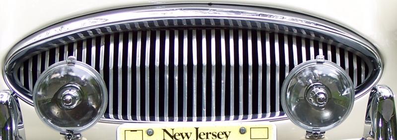

As far as matching the silver paint on the grill surround, I painted my surround when initially completing my Healey back in the late 1980s and the paint is still as good as when original applied. Using generally available aerosol silver paint (I have no idea the brand), I cleaned the area and masked of the area. (2) light coats were all that was needed and the match was reasonably close to the original and I haven't heard anyone say different yet.
Just my thoughts,

RestoreThemAll
Paul, I'm no paint expert but I have used engine paint from a can. Most are far better if they are heated to cure/harden. Heat gun if no on he engine? Wheel paint is pretty tough stuff. It can take heat but for the most part doesn't need so much heat to cure.

VHTpaint is one that I've had luck with. NAPA has it. VHT web site is helpful. I realize that you're not asking so ignore me if you like. I'm married with children so I'm used to it.
pkmh
pkmh
Dale,
Just noticed you left a couple of messages. Never knew new posts were added. But
Thanks for the advice on paints. My surround has been painted for days now. I used the silver engine enamel. Looks nice and hope it holds up. Too late on your advice but will keep it on record.
I went back to the grille and swapped out a couple of slats with better ones at the extreme ends. Drilled out the old rivets and had new ones ready. She is looking real nice now. Will post pics soon, preferably when everything is back in place.
Paul
