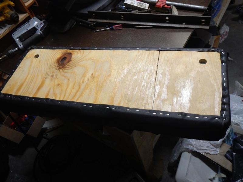

I am now building my rear seat bottom that sits on the shelf (later model post 60k) and have seen several photos showing various thicknesses. Mine is gone as it got wet. I called Moss but they are working from home. I’d appreciate some rear seat photos and thickness measurement. The end of a very long restoration is finally drawing near.

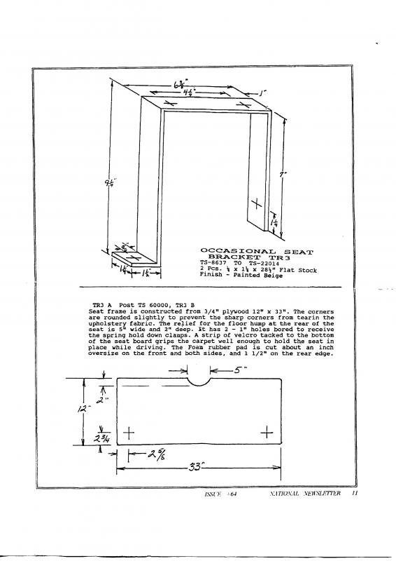

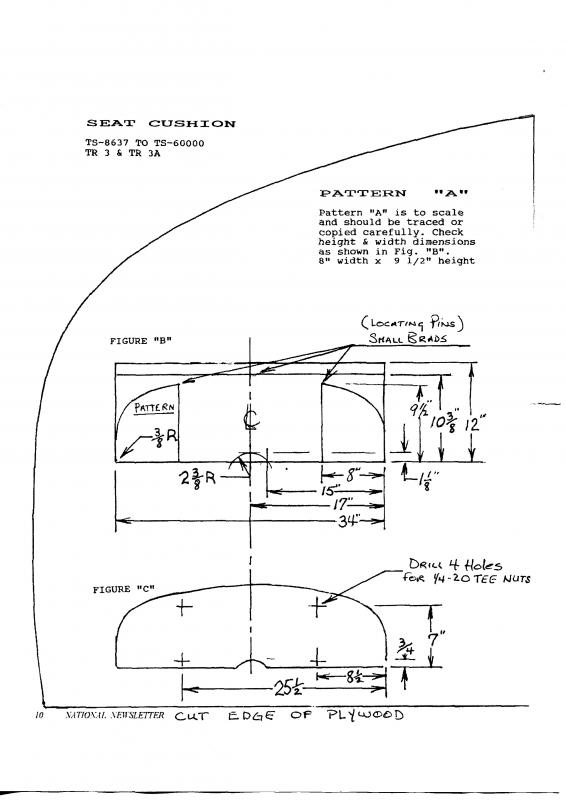

This may help.
Graham
A
Arrow
Thank you! Those dimensions are exactly what I needed. Do you perhaps know how thick (bottom of plywood to top of leather/vinyl is.
DavidApp

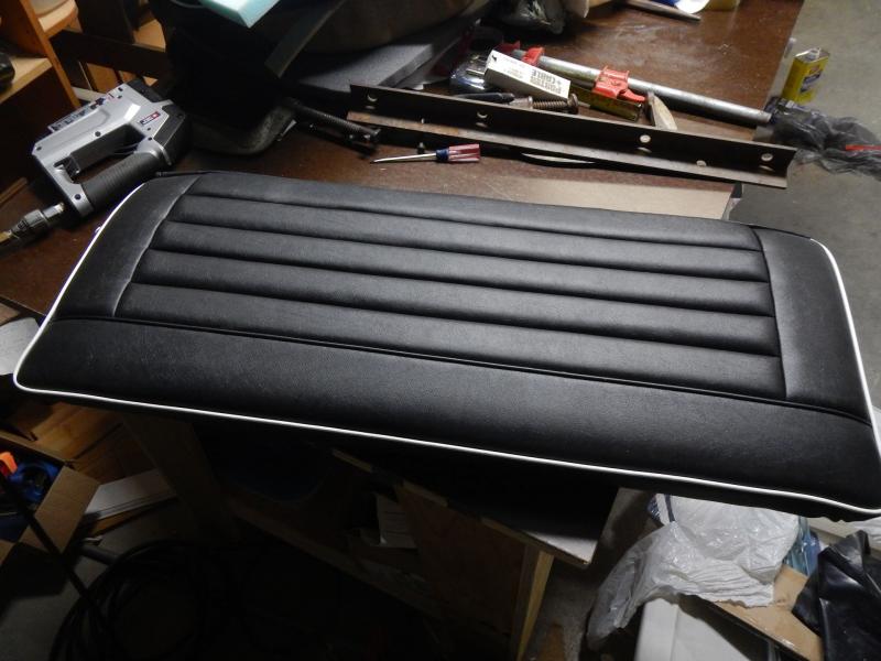

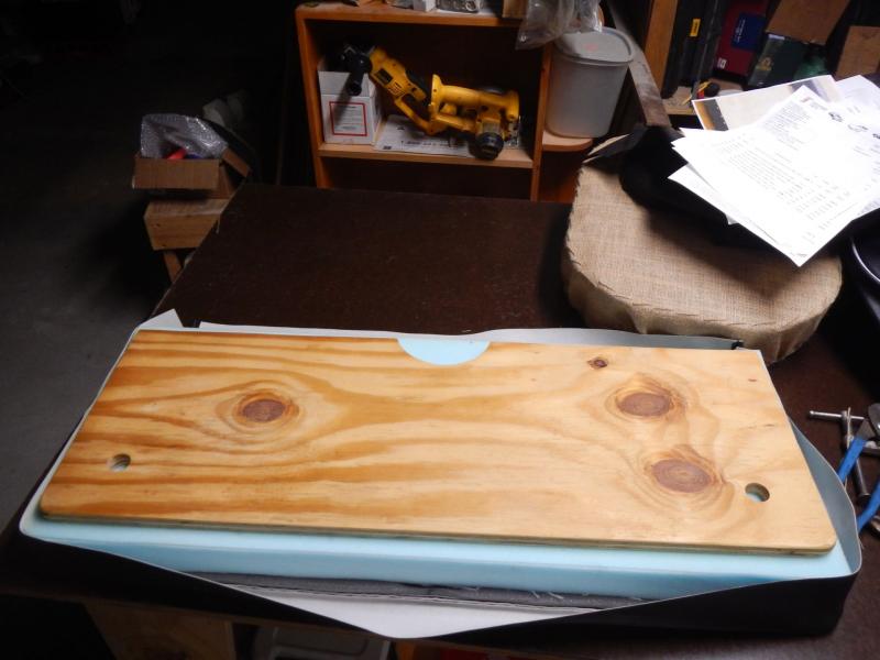

I cut my ply from a sheet of 3/4" and used the dimensions in the last drawing.
Got the foam and covering from Skinner in the UK. The foam appeared to be too thick but I found that by compressing it with clamps I could start to get the staples in the board. Tuned out great.
David

Sorry for the delay in posting the photos.
Back from Vacation now.

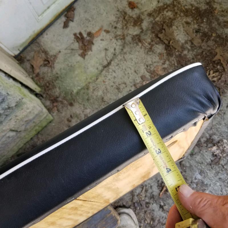

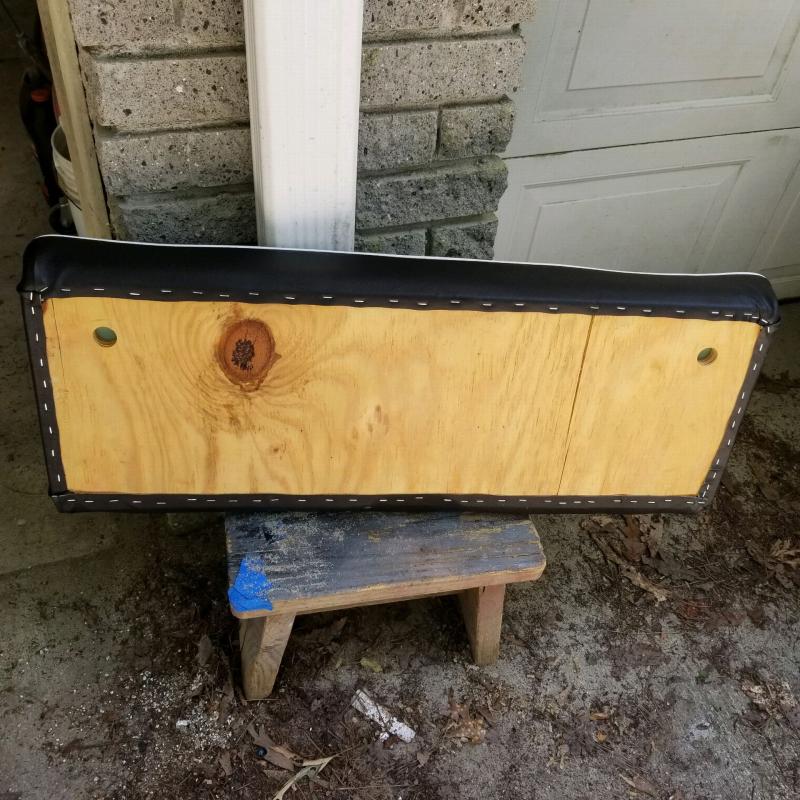

This is what I have on my rear seat. If I had not pulled as much material around to the underside the seat would have been thicker. I had a struggle getting the foam pad compressed enough to staple the edges.
David
