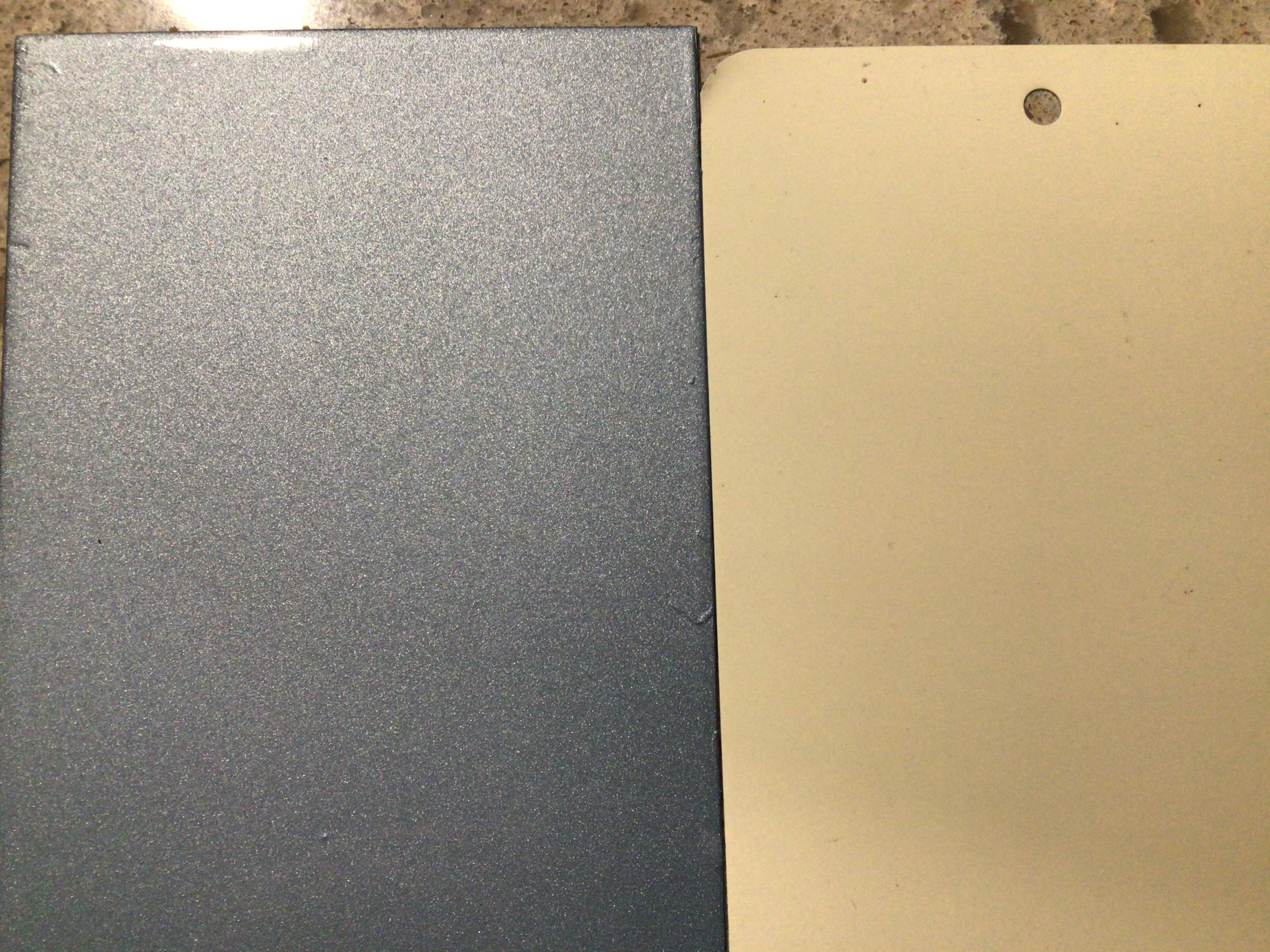

I want to do some touch up on the underside of frame rails on a Healey Blue car. Not looking for the "perfect" match but something in the ball park. Any suggestions for a rattle can product?
Healey Nut
Try this .
