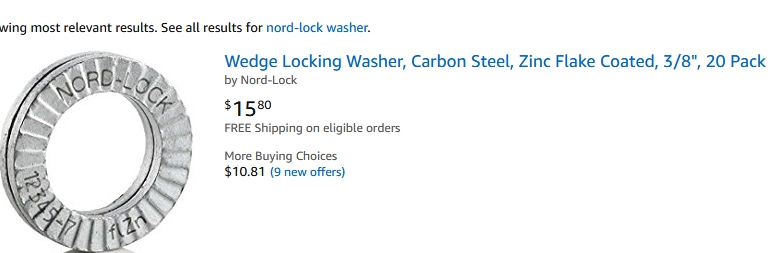

There is something called Nylock (I probably spelled it wrong) washers. It is like two washer with a kind of ratchet together. I put them on about 4 years ago and have not heard a peep out of the shocks since.
steveg
Re: mystery rattle
Nord-Lock washers. Grainger sells them - also Amazon:
https://www.grainger.com/category/washers/fasteners/ecatalog/N-8obZ1z0hk4o
I've had them on my front shocks for a couple of years with no loosening. My rears are tubes so no opinion there.

Thanks for the info about the NordLock washers and the panhard idea.
